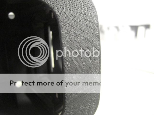

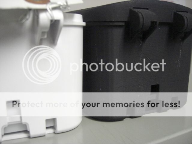

Here are a couple photos of a 3d prototype vs a production part I had sitting on my desk.
The black one is the printed part. Notice the rough surface?
Sorry they are not very clear but the white one is smooth and perfect. The Black (my guess ABS) 3d printed part is rough you can see where every line was printed. A non homogeneous surface means it is weak. Plastic needs to be bound molecularly for strength. Merge lines are inherently a point of weakness. And a 3d printed part is nothing but a merge line. :)
Or perhaps we just get our 3d parts from someone with a crappy printer.
Most of the software used with 3D printers lately compensates for a lot of the warping. So it's not as much of an issue. Most basic printers use PLA with about 80% infill, which sounds like what you're describing.

That was printed on an additive layering printer and thats probably what most 3d printers are. Is it as strong as the white box? absolutely not... Is the white box strenght needed though? in some areas, yes, in most, no.
If you want to add to the bonding strenght of the printer parts, look into Acetone Vapor Bath process. It can be done very cheapy depending on the size of your object. It totally transforms the look and strenght qualities of the printed parts

Interesting Red_liner! Might try to duplicate that. Oh and as for the strength of the white part it is made from a custom engineered resin Polycarbonite/PET damn near bullet proof.
If Kanwar wants to print some test plates I would be willing to do some destructive testing in our quality lab. Would be interested to see if there is any difference in strength after Red_Liners vapor treatment.

With the extruder I mentioned previously, one could easily print with a stronger material such as that Polycarb/PET, so long as it is possible to have it in filament form. And as for that printed part, it looks like it's only around 80-90% infill.
So I'd say it'd be far weaker than something that was printed at 100% infill.

I am still a bit stumped as to how these digital printers get around the need to dry the materials. We need to dry hygroscopic materials in dessicant dryers for usually 2-4 hours before they can be processed. Is it just ignored due to it being not generally visible due to the tiny area that is being printed at any one time? I find it interesting.
