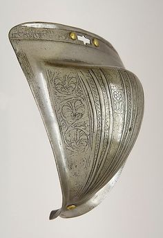

I prefer 14th century.
You have excellent taste, sir.
