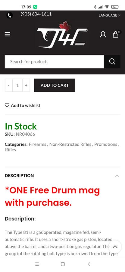

G4C still offering drum Screenshot_2021-10-08-17-09-17-689_com.android.chrome.jpg
