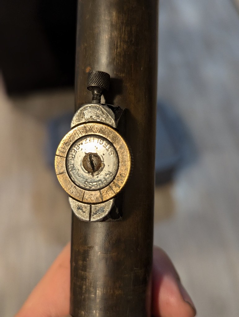

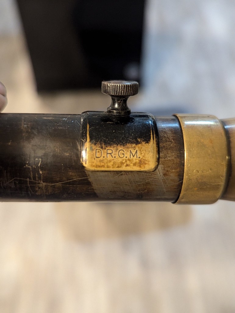

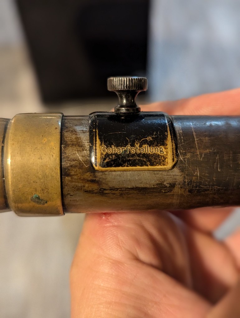

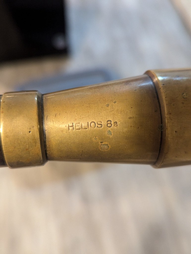

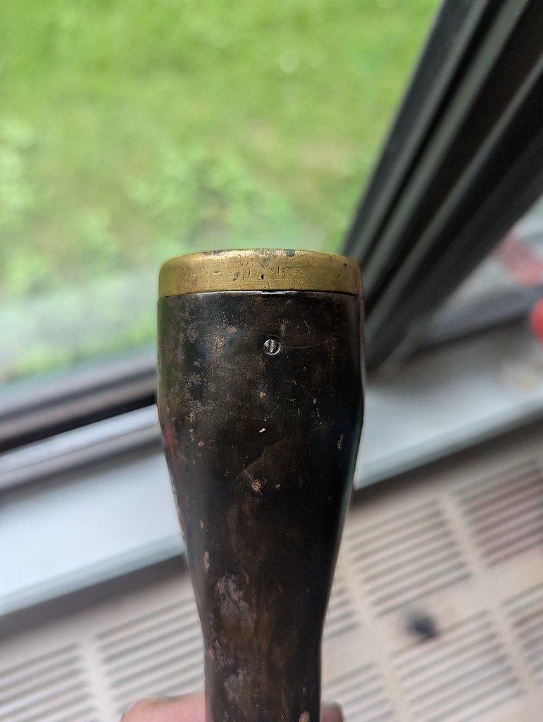

here are some pics of the marking on scope, if anyone knows what it is or has any additional info on this particular scope that would be great
the first 2 pics are on the focus adjuster
the 3rd pic is on the ocular lens
the 4t pic is the elevation adjuster
the 5th pis is one of those little grub screws talked about it post #11
the elevation adjustment has some writing on it hard to read and even harder to see in the pic it says "R. Fufss Steglitz Berlin" i believe
