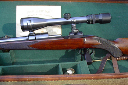

Found exactly what I need for the 648
Paul Jaeger side rail mounts. Much lower then the aluminum Swedish mounts, and they don't cost an arm and a leg to purchase and install.

Nice find! And sits lower than the one I had. Where did you find it? [EDIT: I see a recent exchange on the Swedish Civilian & Sporting Arms forum of Gunboards...]
I'd not heard of Jaeger so I did a search. A real old-world craftsman by the look of it. Died in Philadelphia in Feb. 1993 :( Another article here
Here's a detailed set of pics of his side mount on a rifle.
Griffin and Howe side mount is still made, Pachmayer made a Roll over mount in both side and top mount that may work for you. I think New England actually still sells the Jaeger side mount (N.O.S.)
These are very good mounts. You may only need to lap the rings as 0.024" is preety much nothing....
