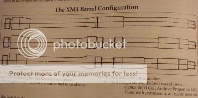

Looks good Claven2. Are you going to reprofile under the handguards as well? It may just be my eyes but that looks a lot thicker than government profile, closer to .750" or so.
If I'm not mistaken, gov't profile barrels are .750 aft of the flange for the front sight block...?
Edit:
See this link:
http://ar15barrels.com/prod/govt.shtml
So it looks like the bbl should have a long taper from 0.675" to 0.625" under the hand guards.
Not sure if I'll bother with that - I don't have a long enough taper attachment for my lathe to bring it down that much and maintain a taper...?
I suppose I could just make it a straight .675...?
Yeah, I'd just pick a straight dimension and go with it. Think Bushmaster doesn't bother with the taper on their superlights, just go with a straight .625", or even .600". I have measurements of Colt lightweights (.625" FSB) that taper down to .600". It might only knock off a few ounces but I think you'd notice a difference, that's what I love about the C8, how light it is, must be around 6lbs or so.
Or maybe Craftsman441 took measurements under the handguards as well? I'm assuming that's what you based the profile off of.

OK, I just got done turning the rear section of the barrel down to government profile :) Looks much better IMHO and it's a lot lighter.
OK, well I decided to go a little further and turn the under-HG profile into a true Colt Lightweight profile and shaved off a few more ounces :) Looks identical to an XM4 barrel now.
I still have seen no real C8 barrel pics of the profile under the handguard, but I suspect this is really close. I suspect the C8 is closer to XM4 profile than government M4.
