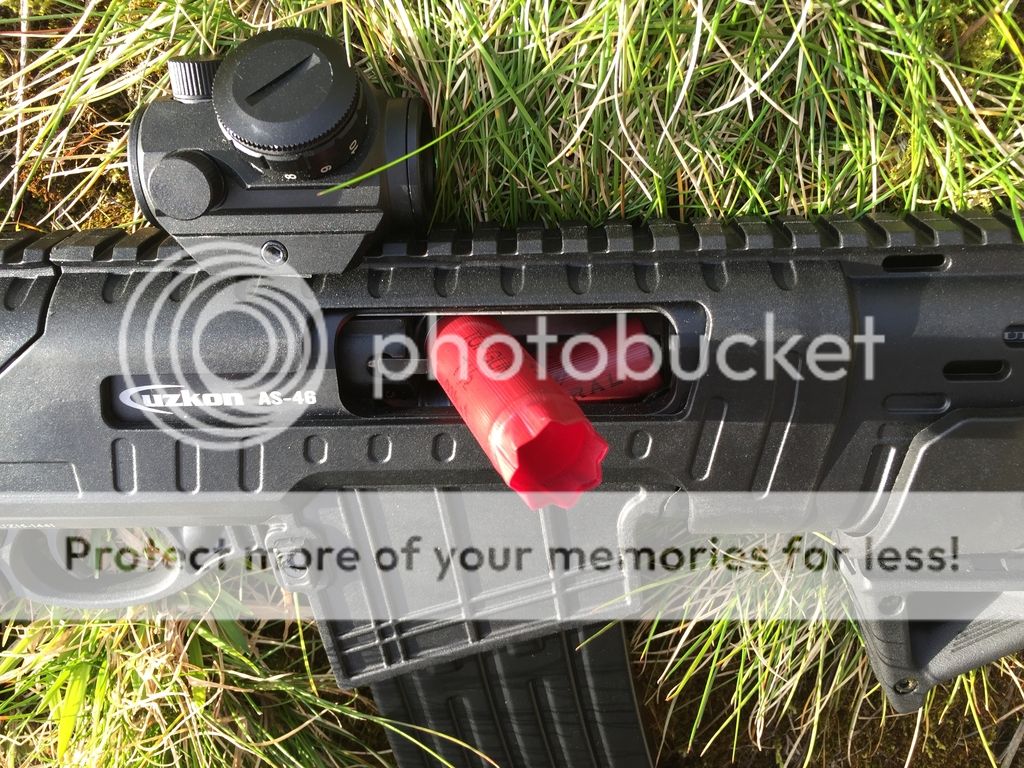

    [*]No way to lock the action open. (will have to see if my range will allow me to use chamber flags instead)

When loading the mag (just have the 5 round mag right now), be careful not to push the rim of the round behind the rim of the round below it. If it does get behind the round below it, it may get stuck on the forward stroke and fail to feed forward if rely on spring power alone to move the pump forward. If you stroke forward with authority, it will still feed ok.
