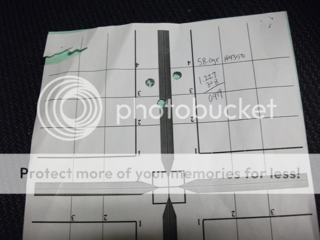

Now for some load development. I will update on the range results and post pics of this project. Enjoy.
