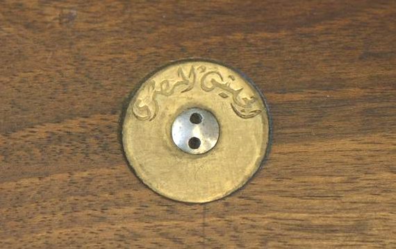

Source for a spanner screw for stock disc
Walther_PPK
218   0   0
NL
Is there any rifle (other than the SAFN-49 or VZ-24) that take a screw like this? I need one but I can find anyone to ship to Canada. If I knew more rifles that used such a screw I could at least broaden my search.
You're looking for a modern replacement, or an original part?
The current 2-hole security fasteners (Snake Eyes) will be found with a fine thread pitch. I imagine the pictured item has coarse threads and a point, i.e., a wood screw.
A bit of solder could fill in the slot on a suitable screw, then drill a couple of holes.
That screw looks like the one that holds the butt disc on a German Gew 98. The proper screw has a slot in the head.
