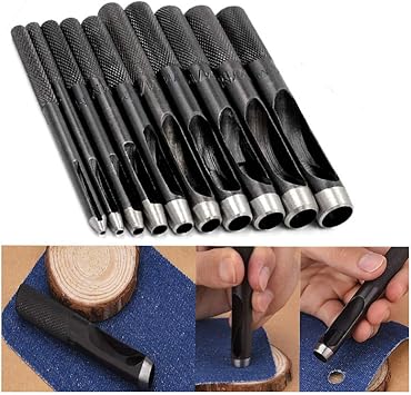

buy a set of these and make it out of leather, drink box, news paper or whatever.
I cut my own 28 gauge overshot cards with a punch like those shown. I do a few hundred at a time, and it saves me close to $200 on a batch of 5000 loads. The best material that I have found, is Milk Bone boxes, as they are thicker than most pizza boxes and other cardboards.
Same punches I use for shotgun 28ga same size as .54 .I use felt wads under conicles.Cereal boxes should also work for OSC's.
