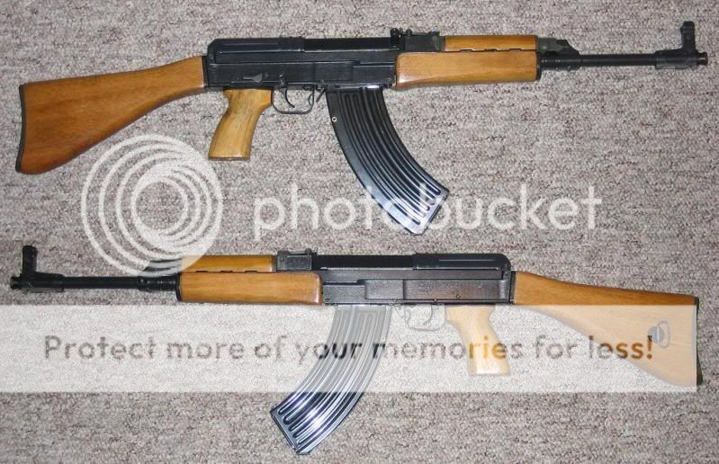

Here are some pics and vids of my gun. It is all the same gun. It used to be a folder, now it is a woody.
