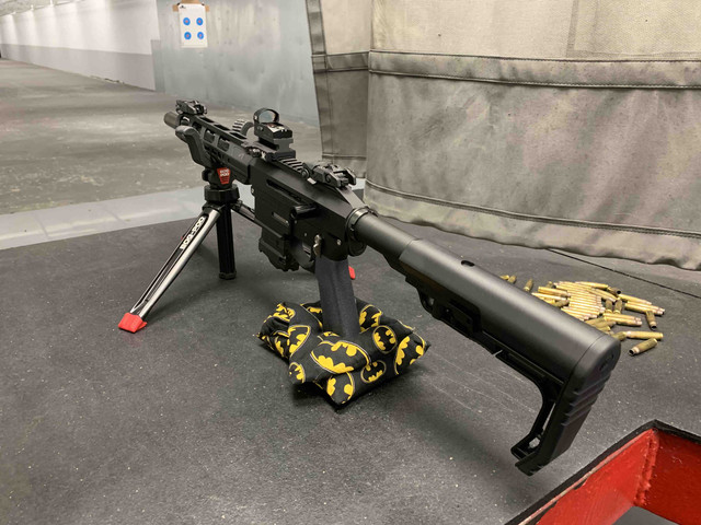

Ok. I finally got the LPC to the range yesterday and ran 60 rounds through it.
Specs:
- MRA V1 match 10.5" 223 wylde barrel
- Dlask linear compensator hand tightened with red loctite
- MRA V1 9.5" handguard
- Triggertech competitive 3.5 lb trigger
- MFT Minimalist Stock
- SBI 3D printed carbon fiber stock
- Brownells nickel-boron MP bolt
- Cross LAR-15 magazine
- 5.4 lbs as seen without ammo
- Total length with stock retracted is 27.5"

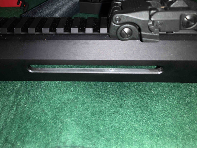

After shooting 60 round (and cycling the bolt 5 or 6 thousand times in my living room :)…) the anodizing has worn off the bottom of the surface that the bolt knob rides on. This is not surprising since the bolt knob supports the bolt and some friction will always be present here. I will be keeping this spot well oiled and do not foresee any future issues.
