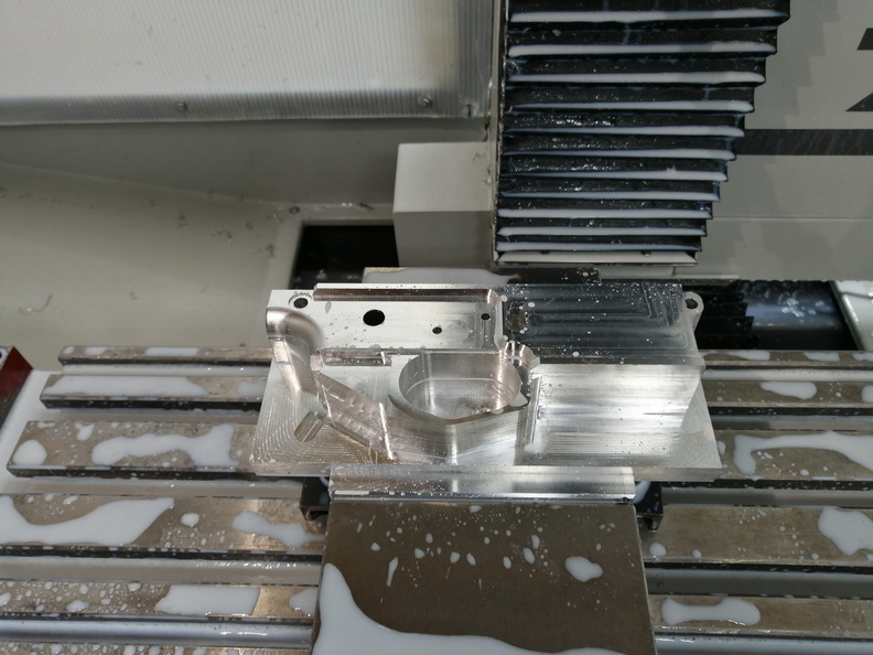

The prototype is coming along well.
When I compare the milled prototype with my and other AR’s, the magwell base is @the base of the trigger guard. Just curious, are regular AR15 mags going to seat properly since the magwell looks shorter? Or is the BCG higher up than a normal AR15?
Our mag well is based roughly on the AR180, not the AR15. We opted for this design to simplify manufacturing. Magazines seat just fine.
