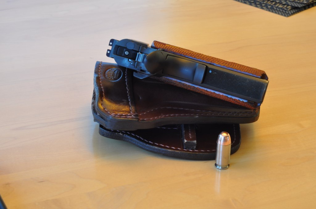

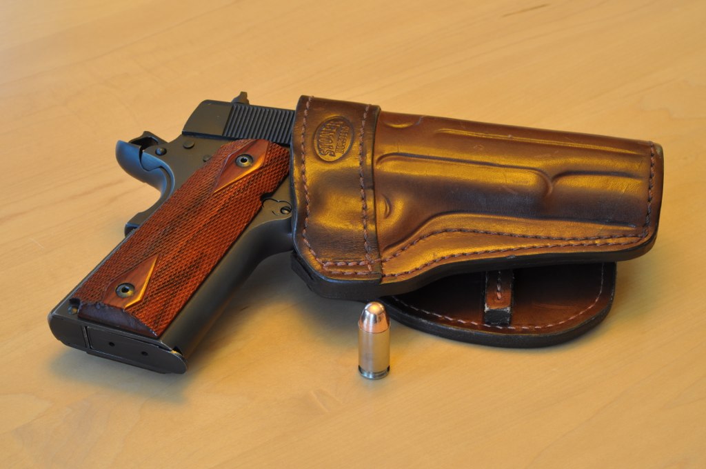

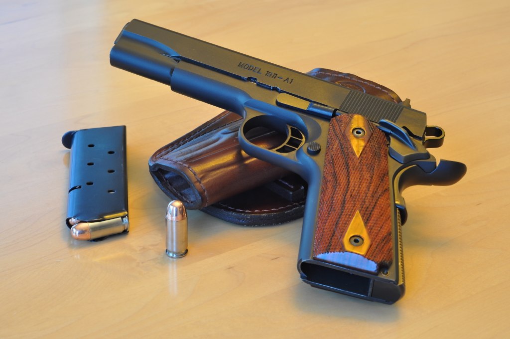

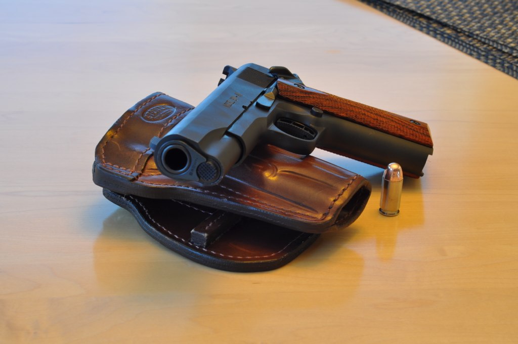

A couple of months ago I was fortunate enough to pick up a Springfield 1911 GI on the EE. I've heard these were fantastic platforms for a project with a forged slide and frame so I picked it up and have slowly been enhancing it.
Anyway, I finished the project yesterday and this is now a fantastic gun to shoot with tight groups and flawless feeding.
In addition to the original frame and slide, I retained the original barrel and polished the throat, breech hood and also the feed ramp. Other than that every part has been upgraded with hand-fit Wilson Combat, Ed Brown and Wolff components.
I'm real happy with how it came out and thought it would be fun to share some photos. Thanks for looking!

Thanks. Great point and I definately kept that in mind while working on it as I did not do anything permanent to the frame, slide or barrel (other than the feed polish, etc) and kept all stock parts. I can restore it to its factory-GI state in about 20 minutes if I choose to.
Yes, I noticed that all your mods looked reversible. I'm not a fan of a beavertail grip safety, but I realize I'm probably in the minority on that. Not being critical, it looks like you did some good work.
is that a drop in beavertail?
Yes it is a Wilson Drop-In for a Commander (fits the SA frame better due to the smaller tang radius). It required some fitting along the sides and had to tweak the safety slightly. I chose a drop-in as I did not want to modify the frame so that I can return it to its milspec state.
I see, good job.
I asked because the gap seemed too big to be hand fit as you said, but it seemed much smaller than the other dropins I've seen.
Thanks - I figured the little gaps due to the beavertail are a trade-off I could live with to have the option to return it to a milspec if needed. Some research told me that to minimize the gap on a springfield to use a commander beavertail not a full size / governement and it worked fine.
Most of the 'hand-fitting' occured on the barrel bushing, firing pin stop, thumb safety, sear, hammer, extractor, ejector and trigger. The beavertail only needed a bit of minor adjusment to fit.
