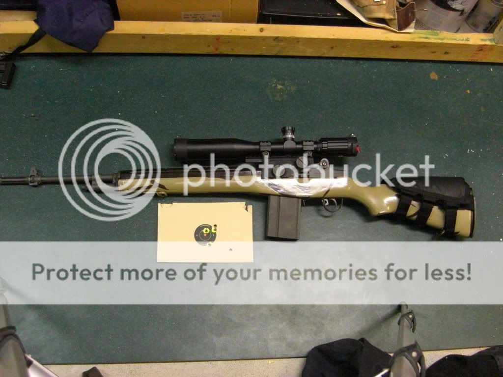

This is the best grouping I have shot to date with my norstinko.
Shot at 200m using Mexican matched Spanish surplus.
The rifle its self has had a light workover by me.
2007 stamped M14s
-NM guide and wolf springs
-Unitized and shimed gas system
-Springfield gen 3 mount(700rds and still holding zero:dancingbanana:)
-Burris Tactical rings
-Supersniper 20x glass
-USGI fiberglass stock thats tight on the action
-NM spec ream on the flash hider.
-Tightened up the oprod guide.
Total build cost came in at just shy of $1000. Im happy. Would I spend the $2300 for an M1A? Big negative on that one.
Big thanks to Hungry for all the knowledge he has blessed us with. Thanks man :cheers:

Since this topic has gone on the "accuracy topic" why is my m14 more accurate at the 200m then at the 100m? Also my norinco likes the norinco ammo more than IVI but the portugesse is still the best. @ 200m it prints 2" groups and the norinco is 2.5"-3" but IVI is like a little under 5". Also I have some Isreal ammo but this stuff prints nice @ 200 but I always get atleast 1 flyer out of five.
2007 stamped M14s
Hungry here: Thanks for the kind words but I gotta impart all my knowledge on ya before I get run over by an errant bus driver at my high school. :D
WOW, all that for under 1K...sweet look'n rifle, personal preference but I'd have a beautiful walnut stock on that, excellent groupings...is that a stock Norinco trigger group?

WOW, all that for under 1K...sweet look'n rifle, personal preference but I'd have a beautiful walnut stock on that, excellent groupings...is that a stock Norinco trigger group?[/QUOTE]
Yep tried to do it on a budget and I think I did ok. I have plenty of other guns with wood on em had to switch it up a bit. An yes, slightly tweeked Norinco trigger group.
