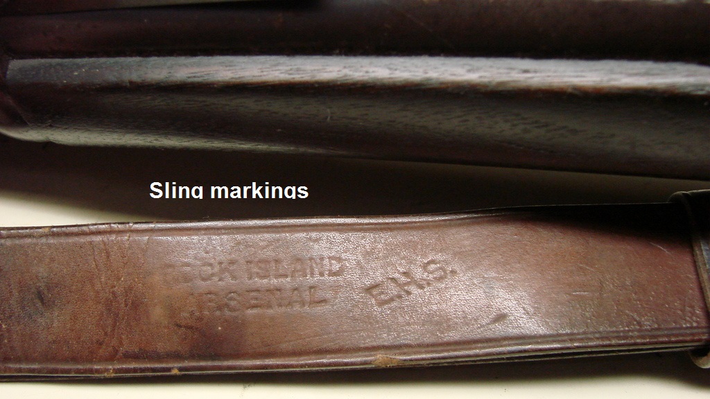

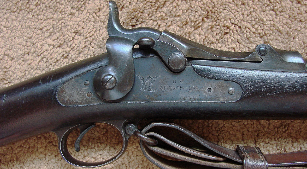

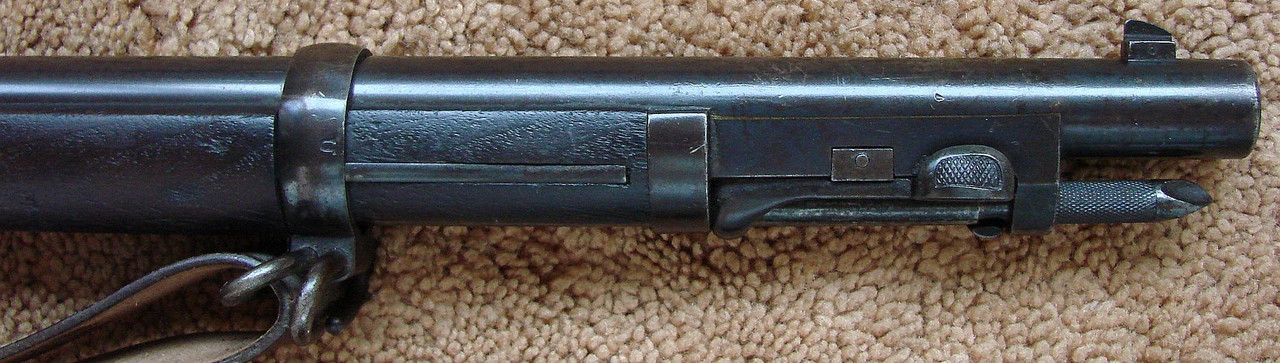

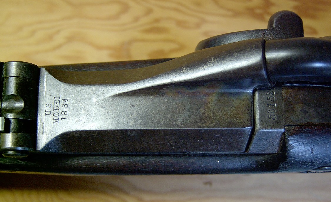

This would have been a decent Trapdoor for you--I think?
Yesterday, I called the fellow that I had traded it to but he had sold it quite a long time ago.
It even had a well marked sling.
Now that’s just cruel. ;)
Seriously, though, nice rifle and sorry to have missed it. Thanks for checking with the purchaser.
I bought it on March 27 2004 together with a M1911A1 Colt rig.
I traded it on September 27 2017.
I think the fellow I traded it to--- sold it at the Montreal gun show some time after that.
