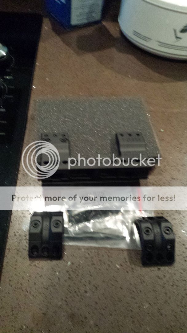

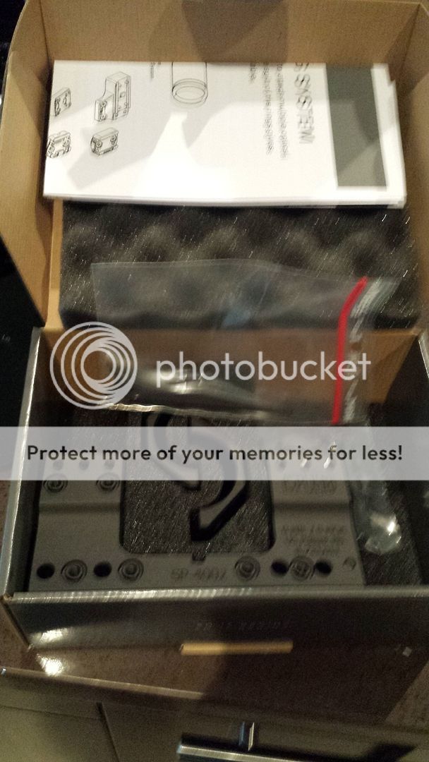

Well, my spuhr mount finally came. Its called the Spuhr Ideal Scope Mount System, designed and made in sweden. The quality of the mount is just amazing, not a single tool mark. The scope mount is PRISTINE, I seriously cannot find a single flaw with its fit or finish.
*blurry photos* crappy cellphone pics, better than nothing I guess?

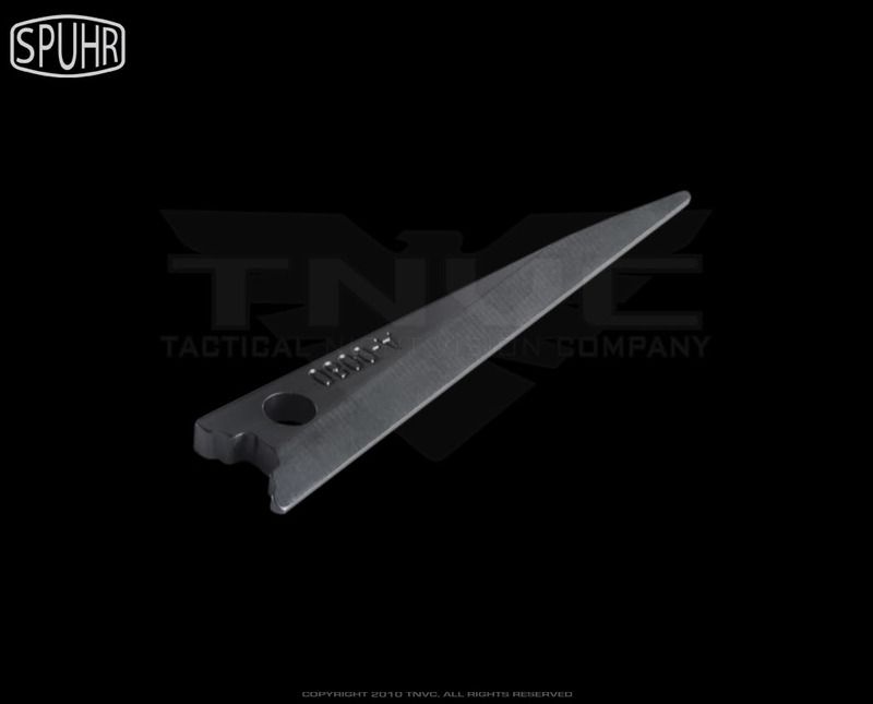

It was fairly easy to install. One AWESOME feature is the levelling wedge (see below) that comes with the mount. It has a 10 degree slot cut into the mount, which you insert the wedge until your scope is lined up with the wedge. Their idea behind this is, if you are buying this mount, your going to have high end optics which have level/flat bottoms. It had to be the easiest scope install ever (i've installed two including this one). no need for bubble levels or anything like that !

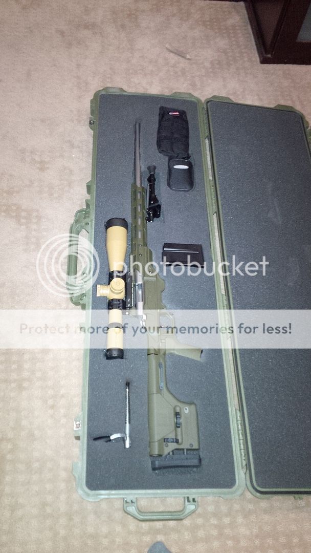

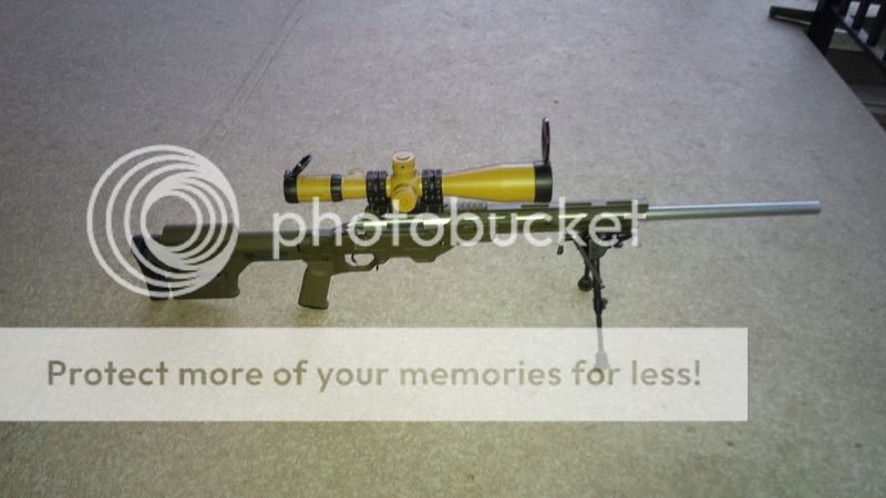

It is a RAL8000 coating, but I'm just nervous about ruining the finish on something I just paid 4k (still paying!!) for. I already screwed up last night and put a sharpie mark on parallax adjustment. Luckily some 91% isopropyl alcohol made quick work of it. The coating def looks very thick/high quality, I just do not want to ruin it my first time out. I already had one scope get ring marks (finish marrs, NOT dents) and not realize until I went to sell it.. Luckily the guy buying didn't mind but boy was I ever sweating once I removed the rings (burris zee signature rings, 1" non lapped on a Zeiss conquest hd5).
