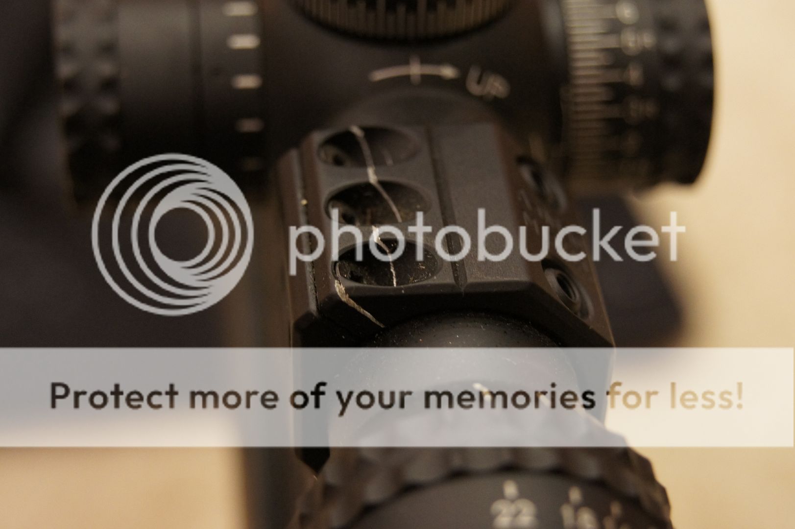

As can be rightly imagined, a mount like this can stand up to some good recoil...
A picture of the one and only time I have known this product to fail. They were very quick on the customer service after I contacted them. They replaced the broken part quickly and free of charge.

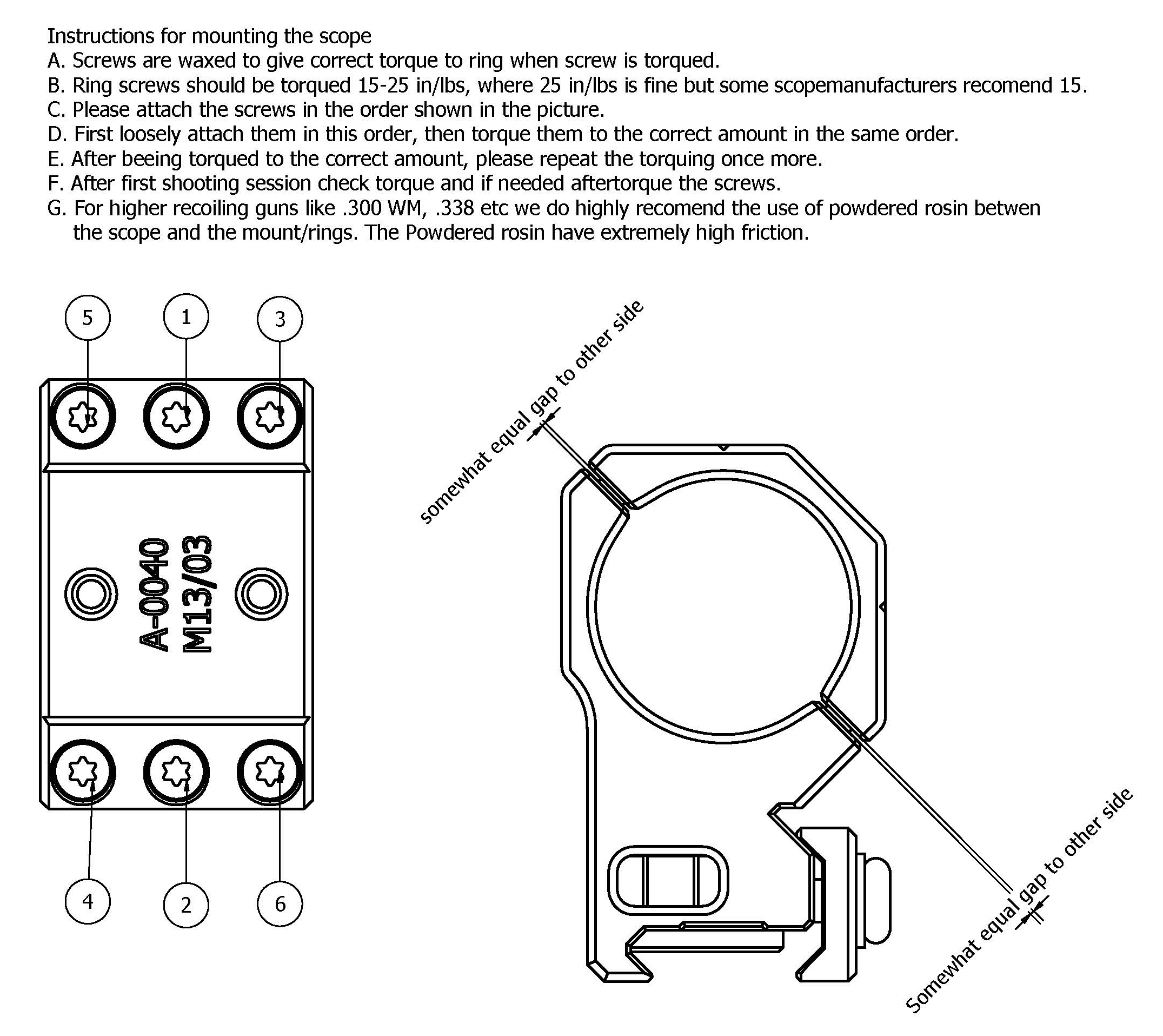

Found this as well on Spuhr's website. These are the actual detailed installation instructions. I didn't have this info included with my Spuhr rings.
http://spuhrwebshop.com/en/ring-screws.html

The one on my Remington developed a hairline crack in the upper clamp at about the 1500 round mark, and when I contacted Spur about it, they were quite surprised and said they have never seen an issue like that, so they asked for photos and torque specs. (20 inch lbs as per spec). Once they confirmed that it had indeed broken they shipped me a new upper clamp ring free of charge, have not had a problem since.
Lots of good info in this thread here, thanks everyone. I wasn't sure if it was going to be a pain in the @$$ to mount, and I didn't buy any rosin, just threw my Steiner in there, crossed my fingers and hoped for the best. The instructions said to tighten the ring screws down to 15-25in/lbs, so I went for the max.
