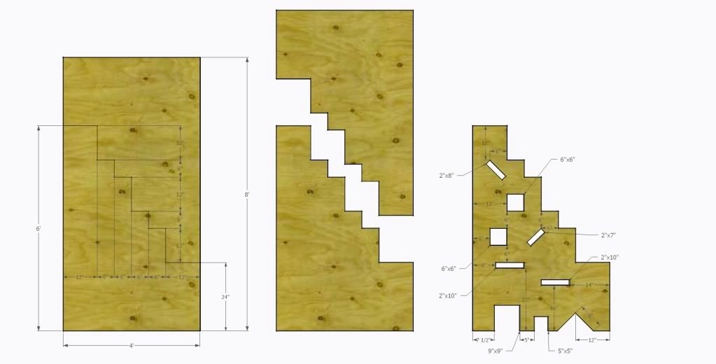

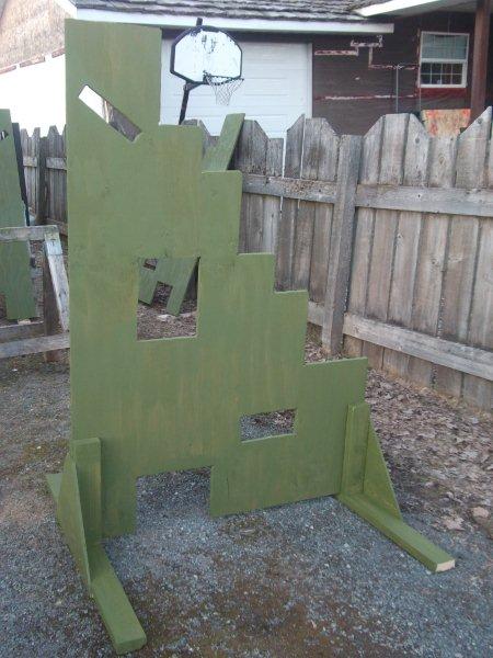

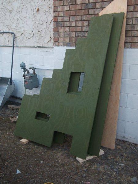

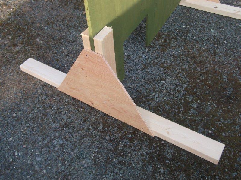

SR Barriers are now built

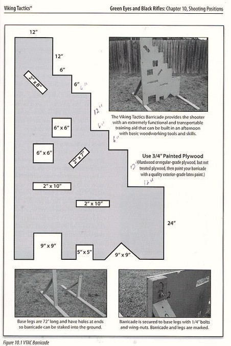

VTac Plans are at the bottom
What I have built is a variant of the VTac design.
IMHO the design is flawed and as such I have made the shooting ports larger and fewer for rifle applications.

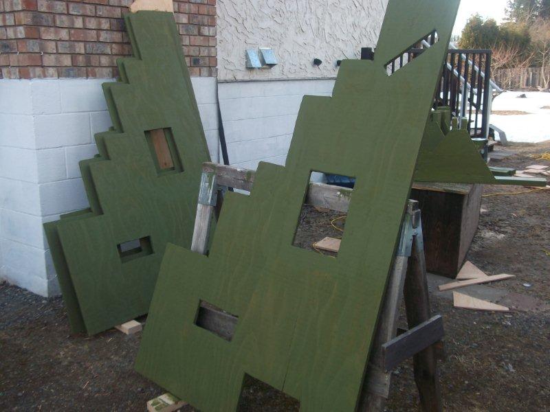

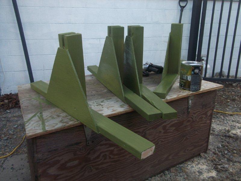

I built six of these over two days and the paint ain't dry yet.
Still more work to do painting the remaining supports
Look at this design - it just makes sense to me.

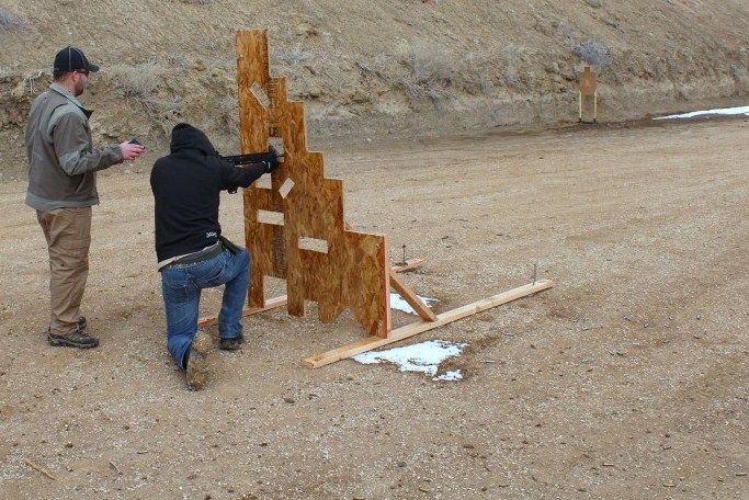

Also have a look at Nutnfancy (forward to time sequence 28:45) on Youtube. When he and 'is homies are shooting in the desert waddies they run a similar run and gun barrier at each station. Too much fun.
Not bad for $230 worth of supplies and two days of work (for one guy - me). This is enough to keep your local Club, Patrol or unit running lots of relays for decades of shooting fun / training. I'd recommend a work team of two chaps though. One full day and you would be done.
