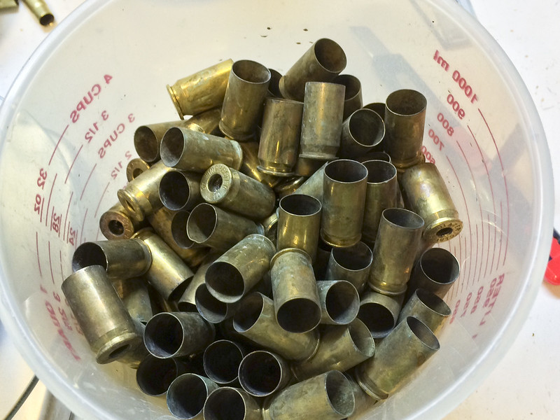

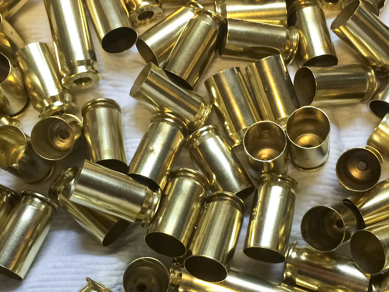

Small lab grade sonicator.
I'm going to try your cleaning recipe, but I wonder if this is what makes the real difference between your setup and everyone else's..
So if I get this right you put water in the sonic tank, put solution and cases head down I would presume, in beakers and then run? Why not straight into the cleaners tank? Do you use a special type of glass beaker? I have read that you have to "condition" whatever fluid you use in the tank to remove air-bubbles or something like that, do you do that?What is pocket scraping, hahaha? Nothing done to the primer pockets, that is how they come out.
Small lab grade sonicator. Can do about 100 cases at a time in glass beakers.
I tried out the vinegar/water/soap solution in my Hornady cleaner without noticeably better results when compared to my usual Hornady sonic cleaning solution. I suspect crazy_davey's amazing results are at least partly due to having a higher quality, lab grade, sonic cleaner.
