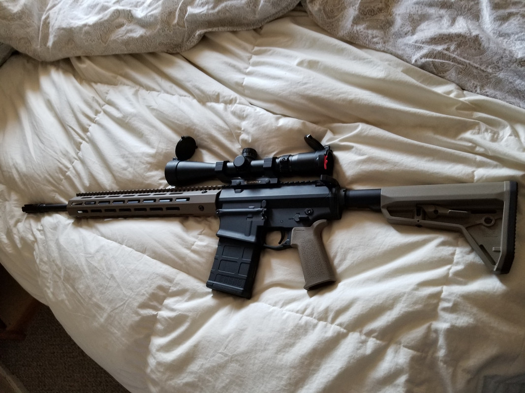

Recently built a stag 10 in 6.5 creedmoor. Never owned anything in this caliber but after reading i really wanted to try it. I took the rifle out yesterday with 140 grain OTM match ammo and it was printing one inch groups at 100 yards. Id like to get out with my camera and a few other types of ammo and stretch its legs. More photos to come. Heres a parts list of what i put i to the rifle:
Stag 10 reciever set
Dpms carbine ar10 buffer kit
Magpul SL stock in FDE
Magpul SL grip in FDE
Faxon BCG
Raptor ambi charging handle
Troy Mlok handguard in FDE
Faxon big gunner match barrel in 6.5CM 20 inch
Rifle length gas tube(unknown brand)
Rainier lo pro gas block
AAC 3 prong flash hider
Optic:
Bushnell engage 3-13x44
Leupold MK2 mount
