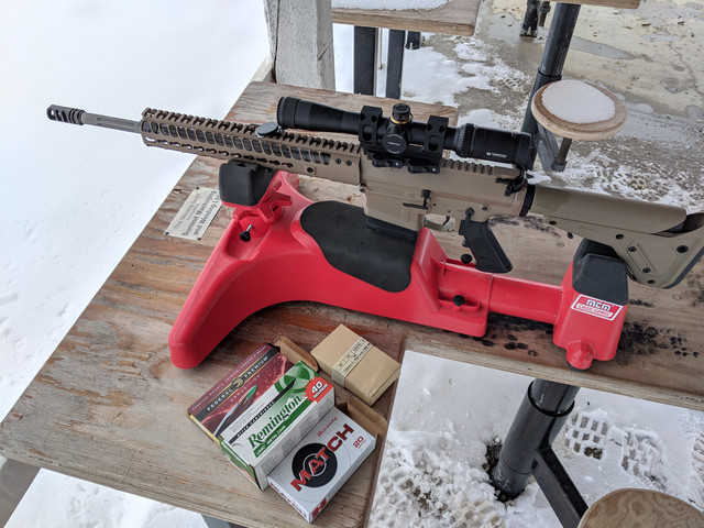

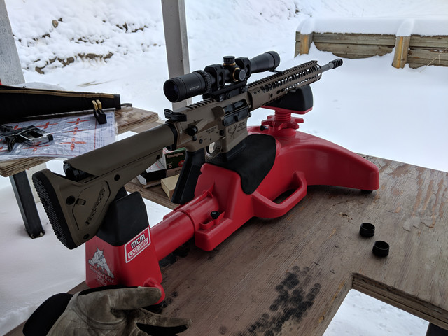

Finally got the last pieces on my stag 10 and will be test firing in the morning. I won't have an accuracy report until I get an optic for it.
I came into this with zero AR platform knowledge and it's been a fun project.
My build:
Armaspec SRS Stealth Recoil Spring for .308 AR / AR10 / BCL-102 / Stag-10 $130
Crush Washer AR-10 $10.00
Precision Armament - M4-72 Tactical Compensator 7.62mm/.308
$160.00
Toolcraft BCG .308
$425.00
60690 DPMS LOWER PARTS KIT with fire control.308 $100.00
STAG-10 Upper/Lower/Rail FDE - Blemished $700.00
TNA Go/No-Go Gauges (SAAMI-Spec)- 308 Winchester-NOGO (MAX) $60.00
Magpul PMAG M3 7.62x51 Magazine, BLK, 10/5RD $60.00
Strike Industries, AR10 Extended Latch Charging Handle, Black $80.00
Maple Ridge 18.6 Stainless match barrel 5R 1-11.25 Twist $470.00
Magpul UBR Gen 2 Collapsible Stock $250.00
SLR ADJUSTABLE GAS BLOCK CLAMP ON .750 $120.00
YHM-BL-04 RIF BLK GAS TUBE $20.00
Vortex Viper HSLR 2.5-10 FFP
$600.00 from EE
American defense QD one piece 30mm scope mount.
$200.00
Thanks for the great service from:
True North Arms
Brownells
Arms East
Red Deer Shooting Center
CTC Supplies
Will update with a range review hopefully soon.
