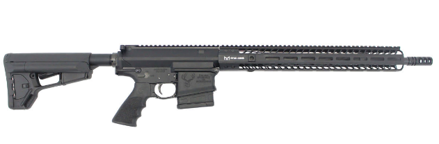

Currently, the STAG-10L weighs in at 8.6lbs in a configuration similar to shown above with the 16.5" handguard. At 18.6", we should still be under the 9lb mark. The barrel would be milspec chrome lined and phosphated, 1/10" twist, 4150CMV.

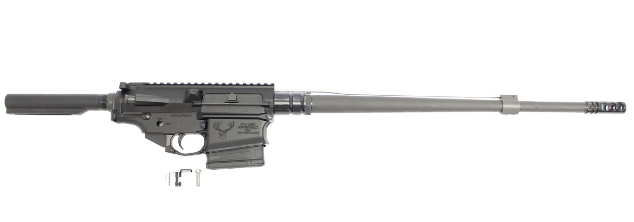

Sample pic of an 18" barrel below, taper to .75" gas block.

Looks very nice, chrome lined and phosphated, 1:10, 4150 is perfect. Definitely 0.75" gas block is ideal.
As a happy medium, having the barrel weigh 2.5 - 2.8 lbs at 18.5" , stress relieved and button rifled would be awesome. I wouldn't expect an ultralight pencil like a Faxon from Stag, it still needs to suit a wide range of people and uses.
I am running the Fulton/Criterion 2.4lb 18.5 inch barrel in 4150 and chrome lined, it's freaking awesome in my "other" semi auto DI 308. Very accurate.

If you can kep it to the 8.2lb weight or less like their medium/heavy 16.5" offering in the usa, that would be ideal for myself, any heavier and it will be a receiver set and build my own.
Edit, please look up the 16.5 version with 13.5" diamond handguard on stags own website for weight of 8.2lbs as it appears I can't link stags own website in your forum

The 16" version has a 13.5" HG and ~2.75" shorter barrel. With the longer handguard and longer barrel for the NR barrel, we are likely going to be about .5lb heavier than the 16" rifle mentioned.
