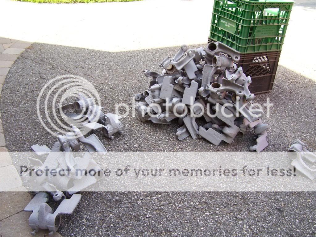

No offense here but I think you are doing something totally wrong if your blasting as you say and washing off casting numbers and such. And here is why I say what I say. I had to get about 100 cast kettenkrad tracks blasted and outside of blasting off the scale and rust it just takes the crap off, all the fine, dinky casting numbers are still there, even the NSU "swoosh" cast into the sections popped up out of the rust and dirt. And I may add these are VERY fine cast numbers and details.It will also peen & abrade any faint marking into non existence. I have mucho experience blasting a variety of materials using various media. No track sections but lots steel/ iron. I could erase casting numbers in an engine block with my old blaster.
