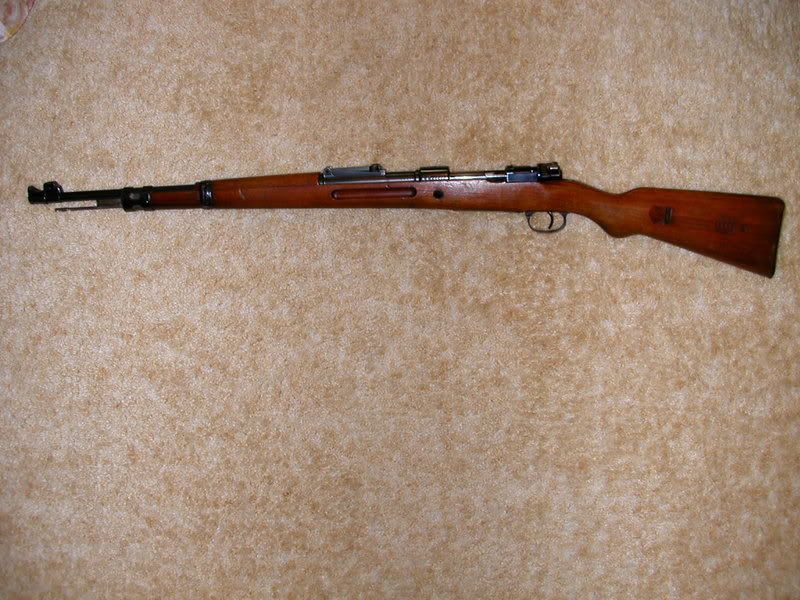

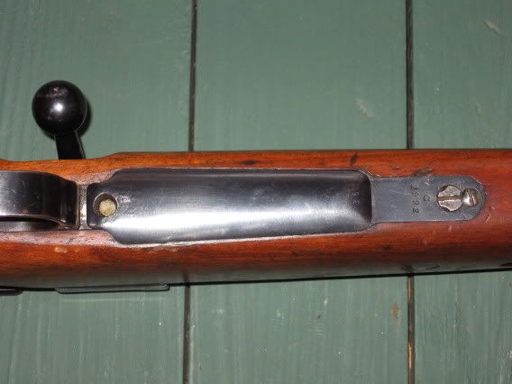

Came by this rifle at the weekend. From what I can gather its a 1933 (or thereabouts) Oberndorf manufactured Mauser converted by Israel to 7.62 caliber.
Seems to be a mix of parts. Bent bolt handle (original early Mauser's I gather should be straight bolt handle..??) and winter trigger guard. The bore is excellent.
Any views or comments by Mauser aficionados would be welcome...
Thanks....

That was originally a commercial non military rifle as it has German commercial proof marks, maybe a target or hunting rifle before the Israelis got hold of it.
That's doubtful it was civilian. More than likely an NSDAP purchased rifle from oberndorf in the mid-30's or a post office or rail service version.
When this was made, the Versailles treaty was still in effect so it would not be marked for military service.
It has a winter trigger guard?I was under impression only those K98s that were assembled by Czechs had those trigger guards.
I'm almost sure those are Belgian proofs on receiver-not Czech.
Those K98 are really something.Very cool.
The israelis re-used there receiver and it got mashed together with K98 parts from all over. It did not leave the Mauser factory with a winter trigger guard.
