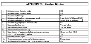

Oh, are you sure 9mm major is not allowed? I was looking into the rules and I only saw power factor minimums, it said nothing excluding 9mm. If that's true then I guess that makes it an simple decision.
For major power factor Standard requires a minimum caliber of .40Screenshot 2025-08-22 at 8.02.39 PM.jpeg
Thank you very much for finding that for me! So I'd have to shoot open, and the TS2 would make no sense for that.
No, you could shoot the TS2 in Standard but being 9mm it couldn't make Major power factor so would be under Minor power factor which puts you at a disadvantage as your hits on Charlies & Deltas are scored lower than those shooting .40.
Alphas are scored the same for Major and Minor power factor in Standard so if you only shot Alphas and had better times you would beat the .40 Major PF guys. Theoretically possible but not easy to do.
