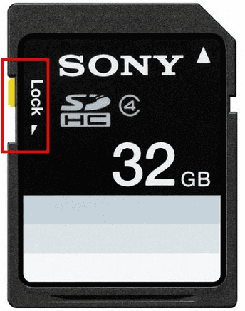

It takes both, 2 slots. I have an unlocked full size card installed.
