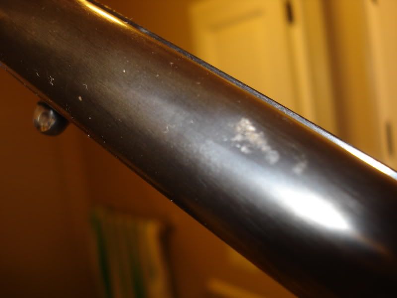

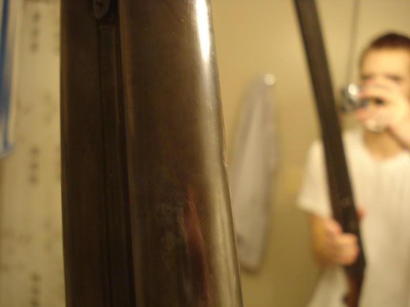

Here's the dent:
Side Profile
(dent is the small dark spot on left side of barrel)

Mooncoon, it seems that you and tiraq are doing the same thing but in slightly different ways. He's using a brass hammer and you're using a curved brass shoe. His will require less hits to form the area since his force will be on a small point but both of your methods will work.
In this case from the picture of the dent the metal is already scuffed from the impact that formed the dent. I actually doubt that the brass hammer as opposed to using a rounded shoe is going to matter in this case.
