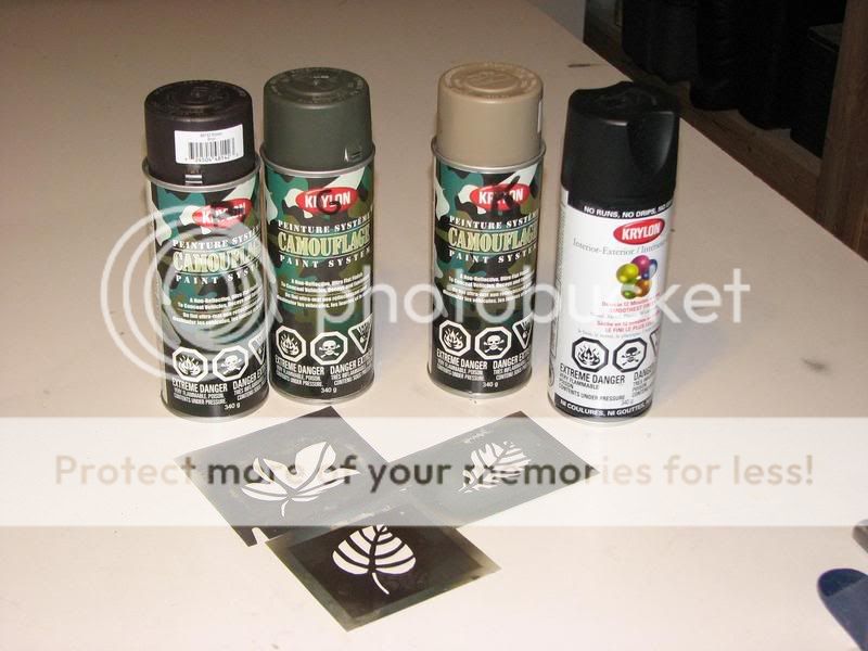

Here is how I Camo'd my Stevens 200 in previous post.
http://img.photobucket.com/albums/v395/crazy_train04/Hunting/Stevens200.jpg
1. Sand down all the ridges and sand with 120 grit or use scotchbrite to rough up the stock a bit to help paint stick.
2. Using the screw holes for the butt pad, screw your stock so it stands up on a piece of wood. Then I painted the whole stock with Krylon flat black seen in picture below.
3. Then in a random order hit the black stock with Krylon Camo Green and Brown (in picture below) leaving an equal amount of black to green to brown when your done.
4. Now go to your closest evergreen tree and trim off a bunch of small branches with lots of foliage.
5. Unscrew the stock from the wood and lay it down on some cardboard and lay down your small pieces of evergreen branches all over the stock tying to cover pretty much all the stock with branches. Anywhere you don't cover will be painted solid Kaki with no breakup. So make sure you try to cover it all.
6. Grab your can of Kaki Krylon Camo paint and hit the stock. Do step 5 & 6 on both sides of the stock.
Now your stock should look pretty cool with Black, Brown and green in the background of Kaki with the outline of the evergreen branches.
7. I made my own stencils for this step but you can buy them too if you like. To make your own stencils I just bought some blank stencil plastic from Walmart and cut out leaves with a exacto knife. (in picture below.) I found patterns of leaves on the net and printed them to trace.
8. Screw your stock back onto the board to stand it up and use your stencils with Brown and Green paint in random orders to create leaves on your stock.
Voila! Camo Stock for cheap. And if you don't like it... Sand it down and try again.
I hope this helps you guys. Good luck.
Here is a pic of the paint and the Stencils I made.
