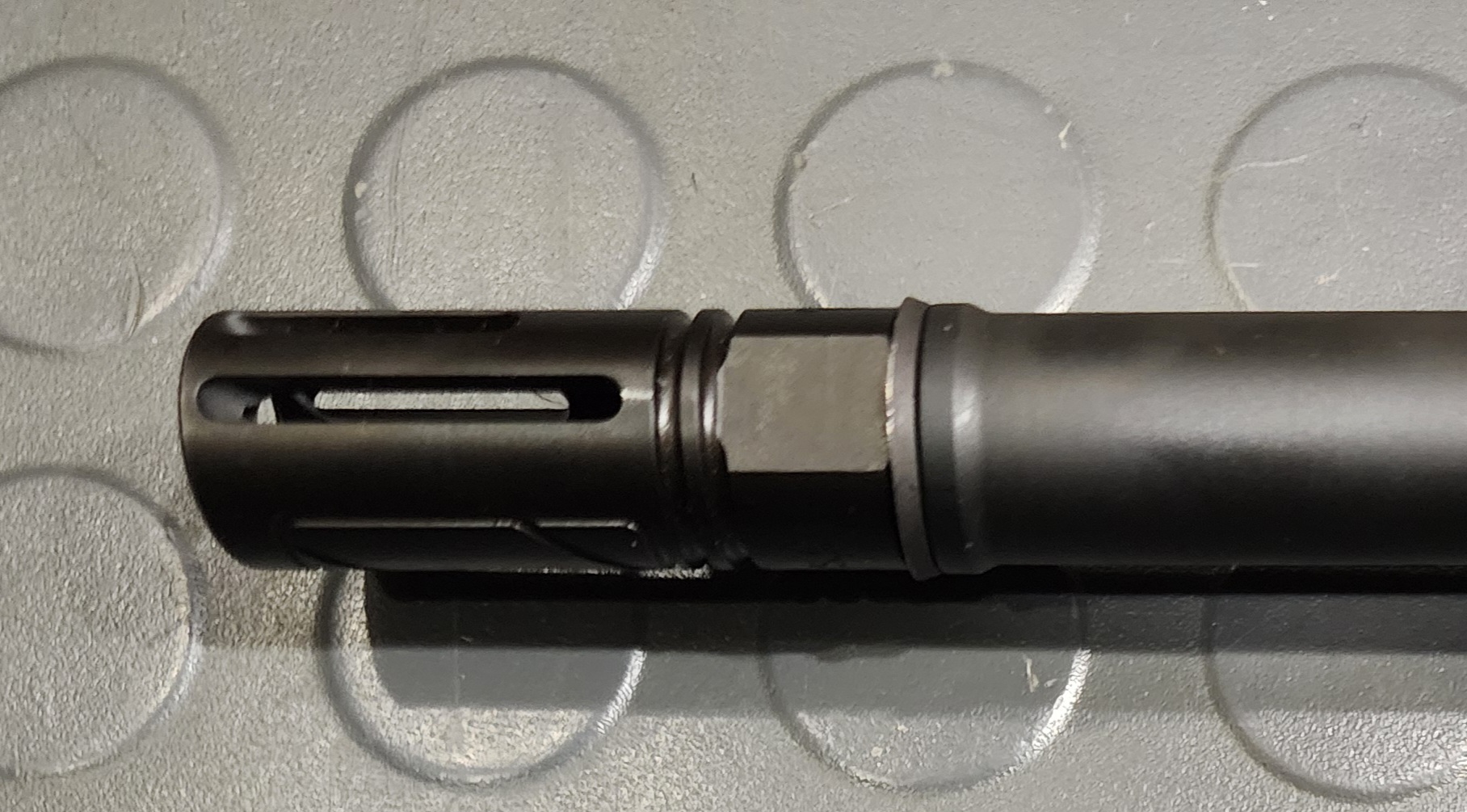

Barrel. The 18.6” Barrel is now manufactured from AISI-SAE4140 CRMo4 Steel, vice 4150 steel, with a durable Melonite-lined Chamber and Bore for longevity. The Mk3 Barrel is manufactured with a 1:7”, 6-groove, Right-hand twist, vice 1::8” in order to better stabilize a broad range of bullet weights and styles. The Barrel is fitted with a proprietary SAI Muzzle Brake whish resembles a standard Birdcage Flash-Hider but which reduces muzzle jump and perceived recoil. The Mk3 Barrel is Medium profile, in order to maintain a reasonable weight while improving the rifle’s balance.
Mk3 Muzzle Brake, Barrel and Gas System (Handguard Removed)

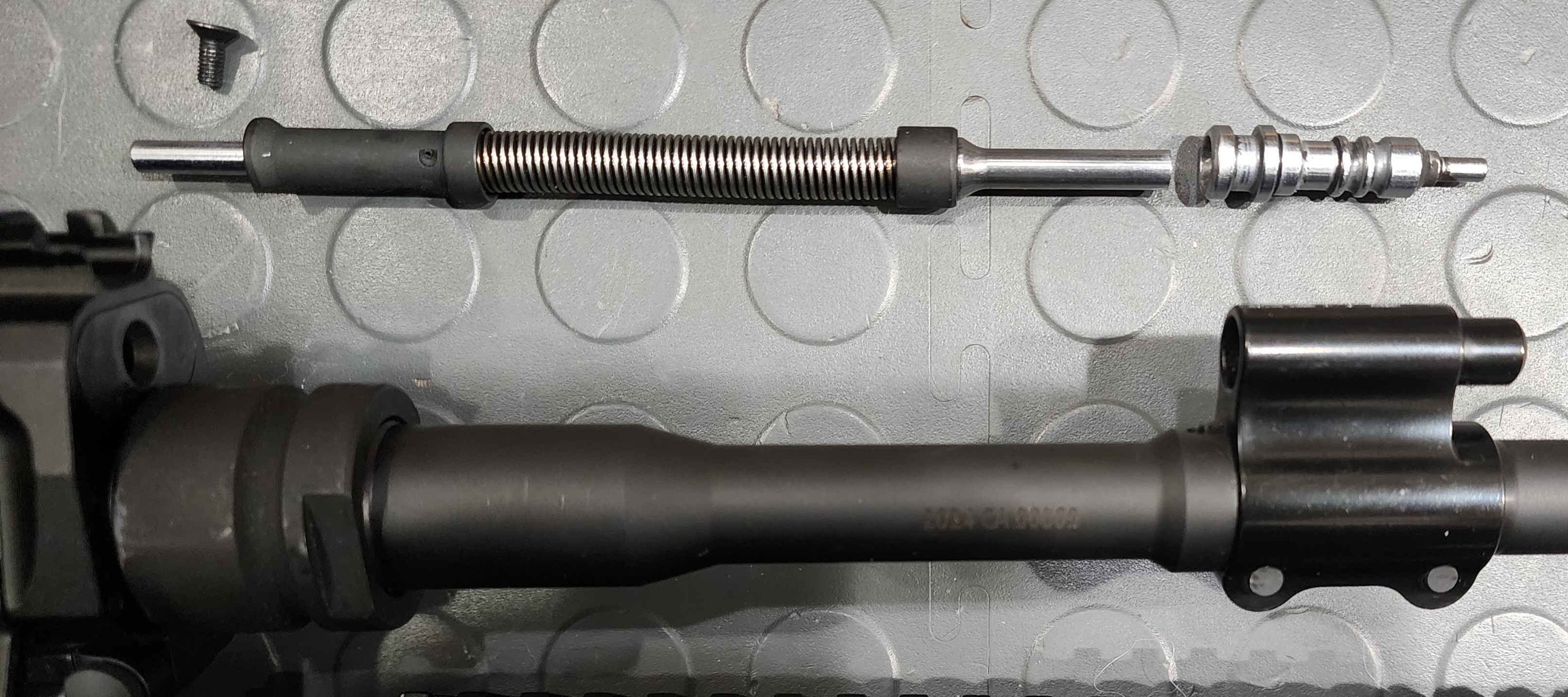

Gas System. The Mk3 makes use of a short Short-stroke, Carbine length Gas System instead of the Rifle Length system found on the Mk2. This results in lighter overall weight, improved balance with the center of balance right in front of the Magazine Well, and reduced Barrel-Whip for improved accuracy. The Mk3 uses a self-regulating Gas System consisting of a conically-shaped Gas Block interior and matching Piston exterior shape. When fully-nested at rest in the Gas Block, the conical, stainless steel Piston is tight against the inside of the Gas Block and seals a Vent-Hole in the front of the Block. Once the diverted gas from a fired cartridge jets up the Barrel’s Gas Port and strikes the Piston, the Piston is forced sharply rearwards will all of the force necessary to fully cycle the rifle’s action. As the Piston and Rod move rearwards striking the Bolt Carrier and driving it backwards to unlock the bolt and extract/eject the fired cartridge, the Piston unblocks the Vent Hole so that excess gas can escape forwards underneath the Handguard. The conical shape of the Piston and interior of the Gas Block ensures that excess gas vents exponentially. This in turn ensures that the Mk3 can never be over-gassed, regardless of the type of ammunition fired. The system “sips” only what it needs to reliably cycle the action. As the rifle becomes fouled through use or exposure to extreme environments, the Gas System simply “sips” more gas to force the Piston and Rod rearwards with appropriate additional force. This self-regulating system was adopted from the HK SL8 and the G36 service rifle. The Gas Block is now secured to the Barrel with Two straight Cross-Pins while pressed up against the Barrel’s Gas Journal Shoulder.
Mk3 Gas System Disassembled

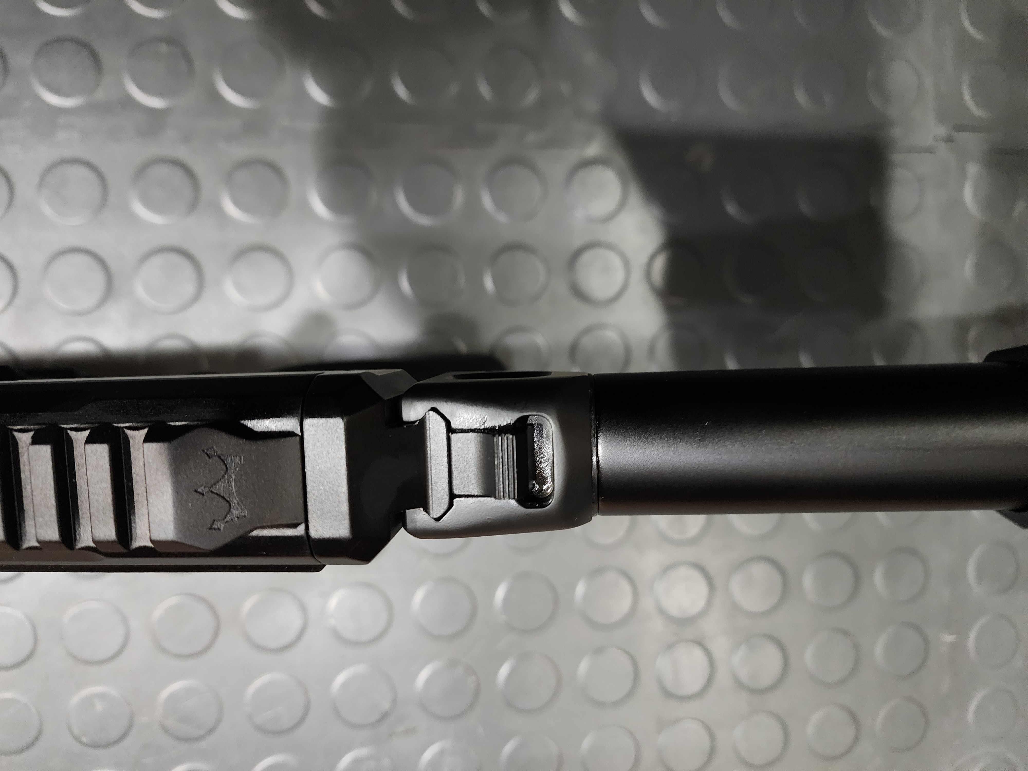

Handguard. The Handguard contour has been adjusted into an oval cross-section rather than circular. This provides a narrower grip while maintaining clearance around the Barrel and Gas Block/Piston Rod. The Handguard features Seven columns of MLOK Slots, positioned at 2, 3, 4, 6 , 8, 9 and 10 O’Clock for the attachment of mission essential equipment.

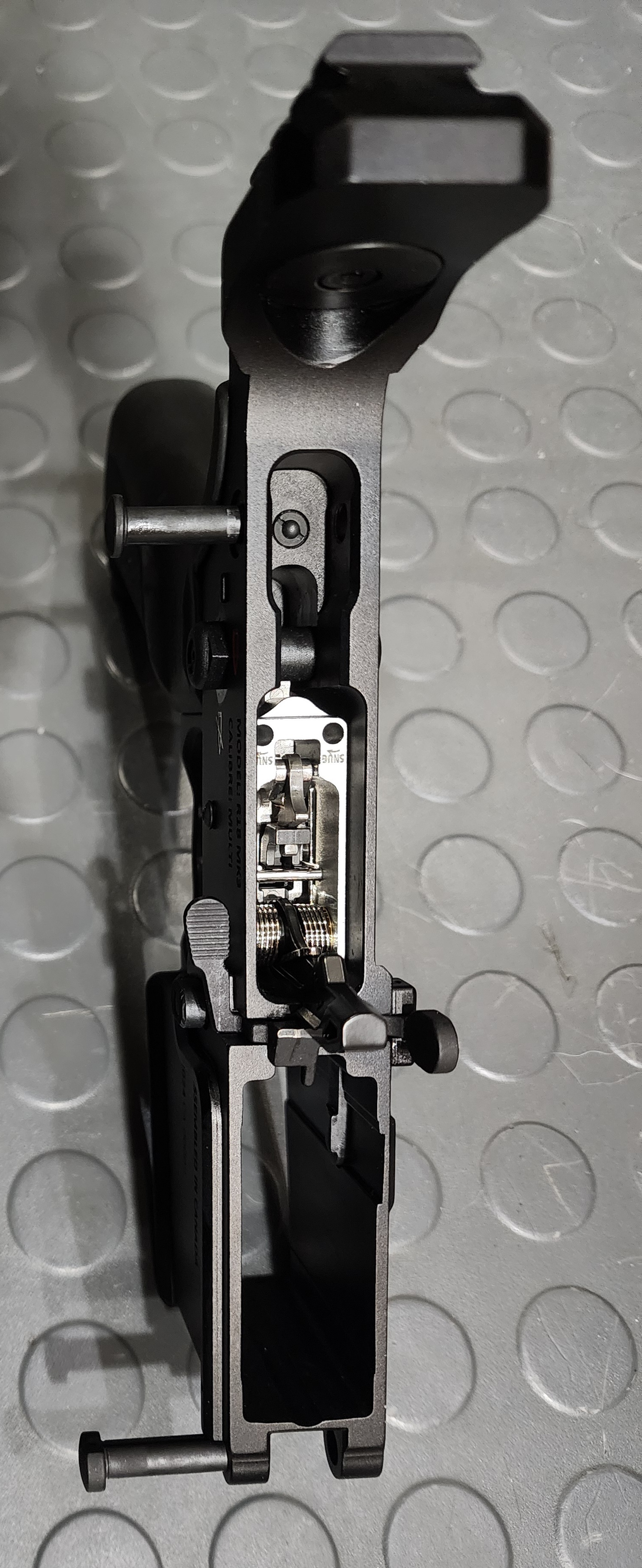

Trigger. The Mk3 uses a TriggerTech “Duty” Trigger with a crisp, fixed, single-stage 3.5lb pull. The Mk3 will also accommodate a mil-spec Trigger Mechanism without issue, suggesting that Geissele Triggers and other Cassette type AR15 Triggers ought to function fine (subject to confirmation).
Mk3 Lower Receiver Showing Spring-Loaded "Anti-Rattle" Pin, TriggerTech “Duty” Trigger and One-Piece Ambidextrous Bolt Catch/Release

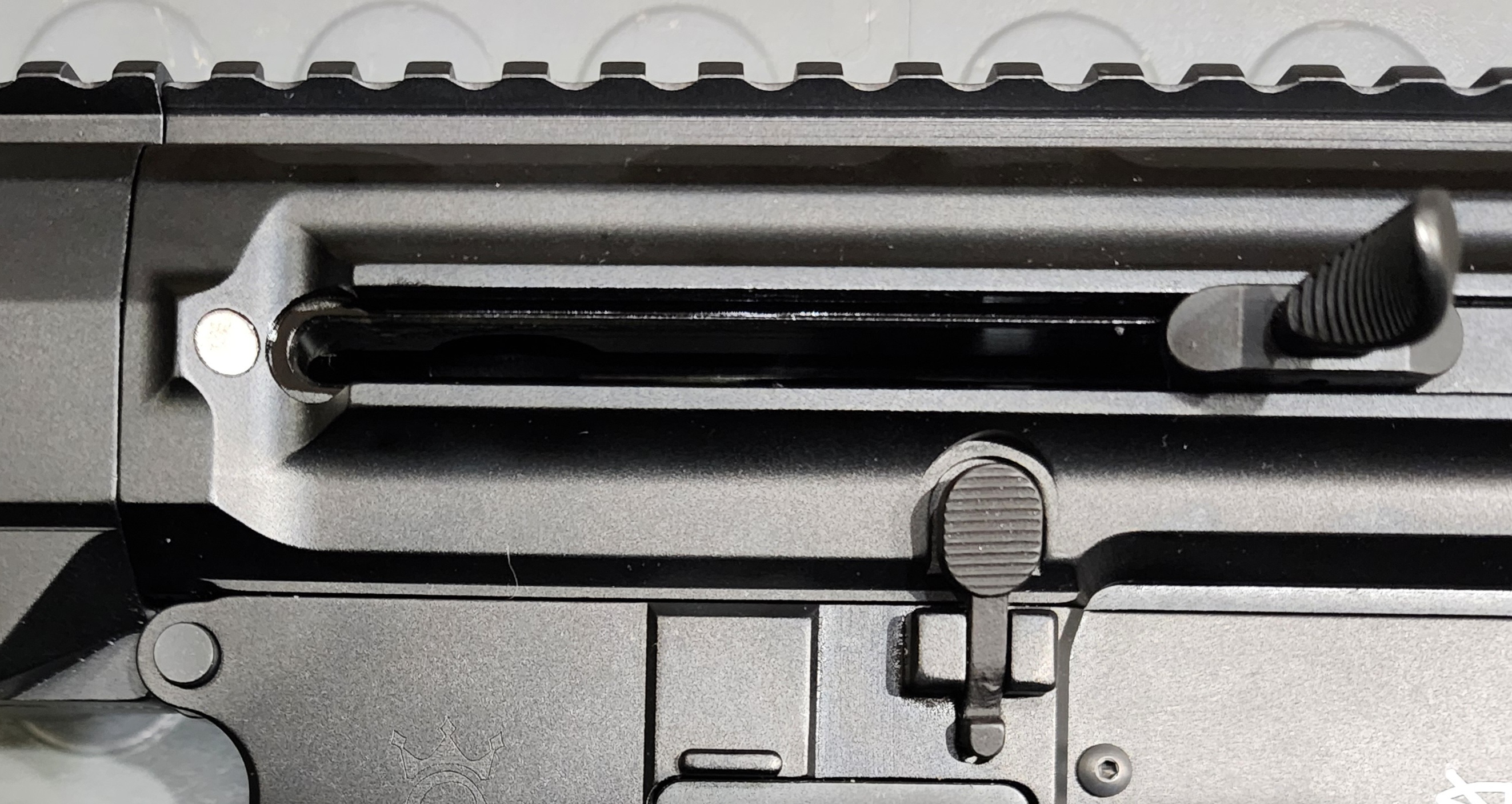

Bolt Catch/Release. The Mk3 features new, integral, ambidextrous Bolt Catch and Release Lever on the Right side of the Receiver as well as the typical AR-style Paddle on the Left Side. The Lever and Paddle are a single piece which allows the Trigger Finger of a Right-handed firer to engage or release the Bolt Catch. This design feature was lifted from the HK MR223.

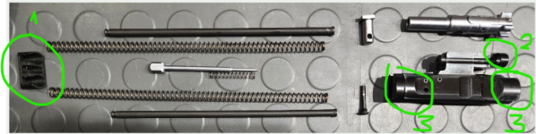

Unitized Bolt/Carrier Assembly. The Bolt, Bolt Carrier, Operating Springs and Guide Rods are now removed from the rifle’s Upper Receiver as a single, captive assembly. Further disassembly into the component parts is a simple matter, however the assembly remains together unless deliberately broken down. This concept was taken from the SIG MCX and greatly eases the Field Stripping and Reassembly procedures. The Bolt Carrier Assembly contains the greatly thinned-down Bolt Carrier itself, two steel Guide Rods, an Operating Spring on each Rod, and a Rear Locking Piece which holds the entire assembly together. The Bolt Carrier runs on the Steel Guide Rods and broad contact with the interior Receiver Walls. The Bolt Carrier's exposed face has 2 indents which are designed to allow operators to use their Thumb or a Cartridge Case to push the Carrier home, fully into battery in the event of a dirty chamber.

Detail Strip of Captured Bolt Carrier Assembly
