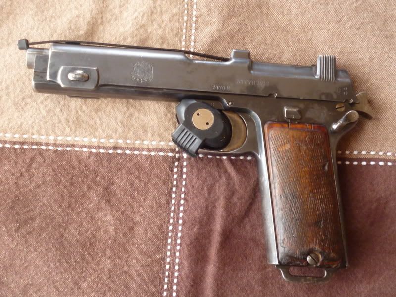

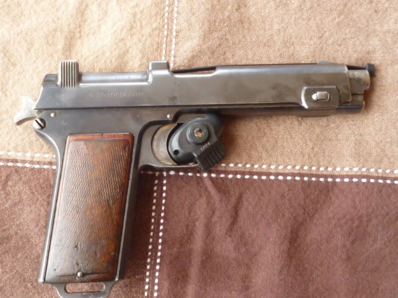

Newest aquisition.
From a CGN'r, and thanks BTW; nice piece.
Not pristine and being Chilean, not that collectable. Still pretty cool. And my gal deserves credit for the fresh-out-of-the-box pic's ( I was away at work)
Very nicely finished, no nonsense pistol. Other than the safety ( probably what Norc modeled their for Canada 201 & 213 safeties off of) and slide release; a totaly ambidextrous pistol.

Don't knock the Chileno Steyrs: they were the SMALLEST contact for this gun and they were the only MILITARY guns marked as Model 1911. The 1912 is the actual date of manufacture, so she is 100 years old this year.... and still one of the BEST semi-autos I have ever used.
The cartridge puts out just about 400fpe at the muzzle, they are DEAD reliable and they are just WICKED accurate if you use the sights. It's a bother to get used to the angle at which they "hang" in the hand; you have to make a conscious effort to raise the muzzle, but the effort is worth it.
The Austro-Hungrian ones, the Romanian and the Bulgarian pistols all disappeared into that political cesspit they call Central Europe, got reworked time after time and gradually beaten and eaten to death. The Chilenos were relatively safe, undergoing only normal attrition from being used. After they hauled Allende and the rest of the Commies out and shot them, Chile disposed of their old warhorses and a lot of them came here. They are VERY rare in other places and many books don't even mention their existence.
This gun makes the most of the Krnka torque-locked rotating barrel system of operation, allied with yet another George Roth high-powered cartridge.
Be careful: it has less than HALF of the parts of a 1911 Colt but it does the same job. MANY parts are multi-purpose and you CAN get bitten. The Switch Button above the left grip is an example: it is a Slide Release for single-shot fire ONLY when the gun is empty; if the gun is LOADED, it becomes an UNLOADING BUTTON. Recoil spring is KEYSTONE shaped and rather amazingly strong; it compresses almost SOLID when the gun is at "recoil" position. The steel slab in the top of the slide is a single piece; it just sits there....but it does SEVEN jobs while it's in place. The whole gun is like that: a work of pure GENIUS.
You will NEED Chargers to load this baby. To load, bring the slide back, then LOCK it back with the SAFETY. Strip in your rounds, remove and pocket that valuable Charger, point the thing in a safe direction and flip off the Safety. Your gun is now Condition 1: safety off, hammer cocked, round up the pipe.
Trigger on mine was over 30 pounds when I got it and creepy and gritty into the bargain. Cornelius Ens at Manitou Gun Works slicked it to a perfect 4 pounds with ZERO creep: nicest trigger I have ever had on a semi-auto.
