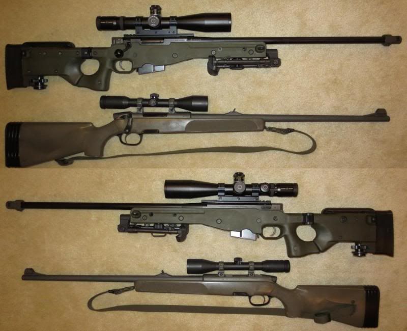

My SSG69 with my AW308:

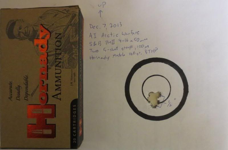

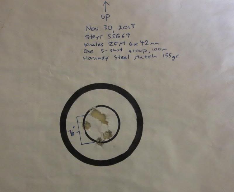

This is about the best I can realistically do on the average day of shooting these rifles with decent quality ammo that they like (I`m using 168gr BTHP with the AW, and the 155 with the Steyr. The Steyr really likes that 155gr. Steel match stuff). The difference is probably more the scopes than the rifles, but as I say, the SGG69 is just not made to be used with a big high magnification scope in my view. With the ZFM you have to sight the shots in to impact above the line. For accuracy, I set it up so that the line just barely touches the thick black circle. Best consistancy that way. The `modern` way is... obviously you just put the reticle right on top of where you want the impact.
The inside diameter of the big circle is 2 and 1/4 inch. The inside diameter of the small circle is 1 and 1/8. Looking at this circle through the 6x ZFM at 100m, the whole circle is about as wide as the centre post on the reticle. You really have to concentrate to get the same point of aim... and even then.

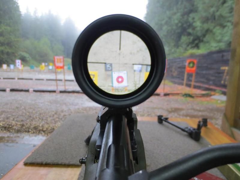

Big difference in the results you can get with higher magnification and a fine reticle like this P4F (unfortunately can`t get much of a picture of it)

Unfortunately, ghostie's comment regarding bastardized SSG's is also true, in spades, for some of the goofy versions available now...such as the two pictured above. I had an original one many years ago, and at the time it was considered (and was!) an extremely accurate rifle, but reproducing that level of accuracy with today's modern guns is easy and cheap. The SSG today, and I'm talking about the classic rifle/scope package, is the precision rifle world's equivalent of a Harley Davidson: it's cool, it's iconic, it has an indescribable and undeniable appeal to some folks, especially those of a "certain generation" :), and it offers a total experience and feel that is difficult or impossible to replicate...but for someone who is looking for the ultimate in quantifiable, measurable performance, it just doesn't cut it. When an attempt is made to make it competitive today, whether by a guy bubba'ing his gun in the basement, or by the manufacturer themselves, you end up with neither fish nor fowl. Nobody is happy, neither traditionalists nor cutting-edge guys.

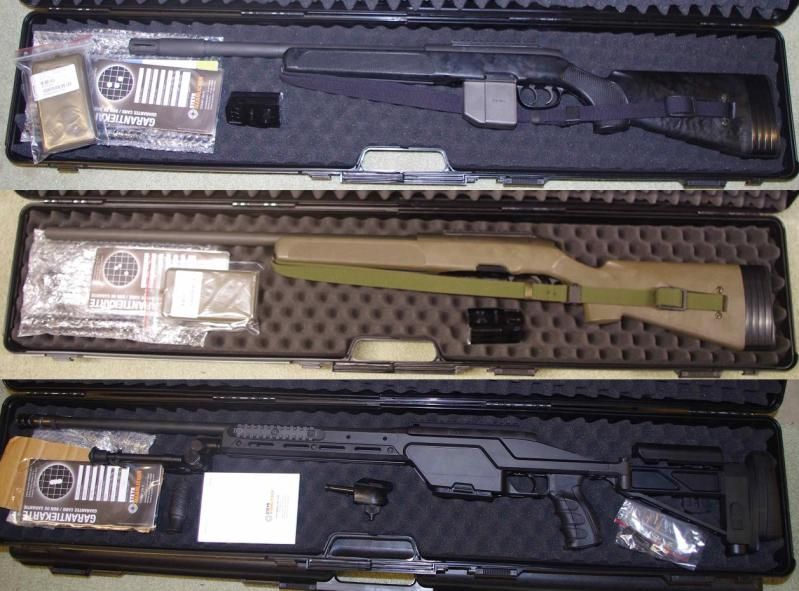

These were some of the rifles he brought in awhile ago. The top one is the PIV, which are available in.308 only and have the short barrel.
I own the PII in olive, but I want to get the PIV next, not a big fan of the Black colored rifle anymore though....
