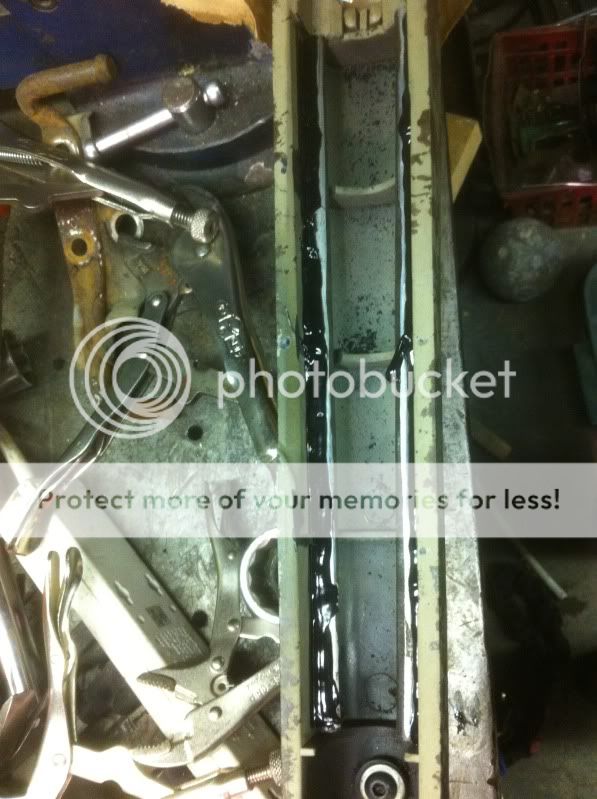

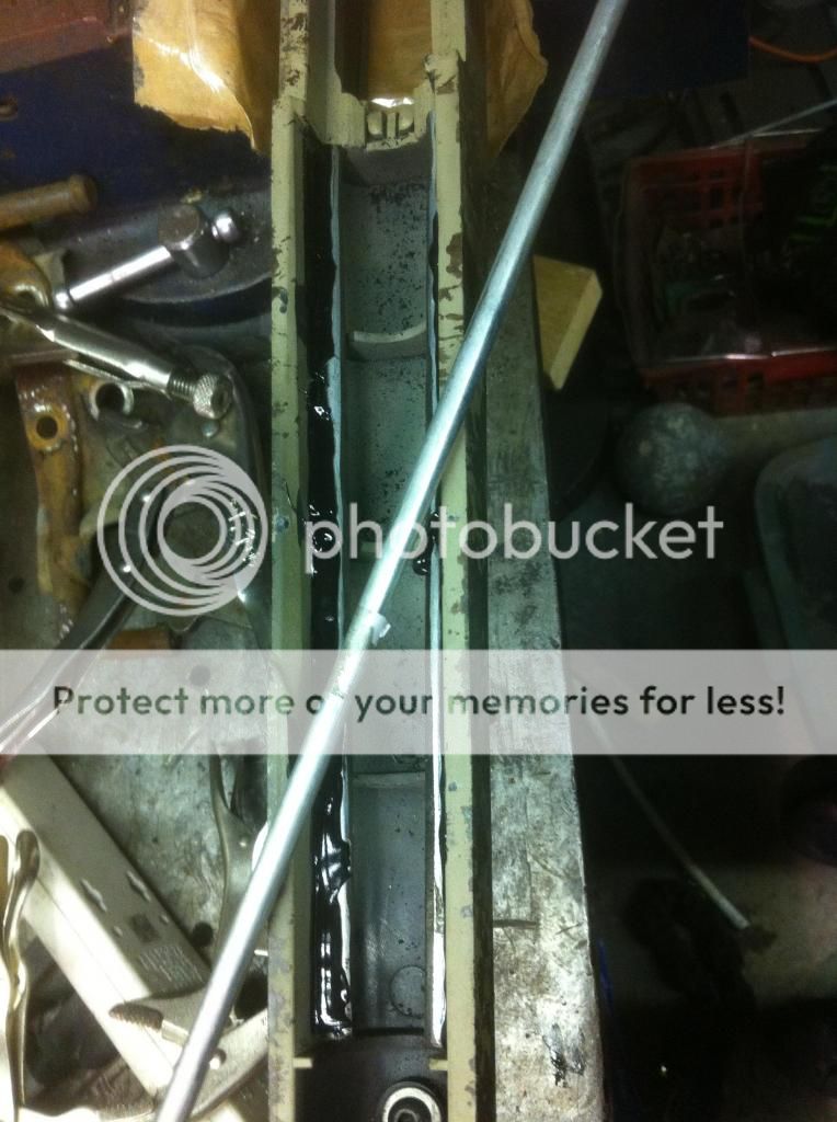

Many thanks to Duck for the inspiration, and heres my go at stiffening the old plastic stock.
I got the Dremel out and removed the side ribs from the magwell forward, being careful to leave the bottoms of the ribs in place...dont know why but it srt of seemed to make sense...(some engineer out there will know about that sort of thing ). I didnt have any arrow shafts laying around in the chicken shed but I did have some 1/8 x 1/2 aluminum.
Drilled some holes in that for the old JB weld to anchor to, and scored the inside of the stock, again for the JB to anchor to.
The only techy bit about the whole job was taking the file to the aluminum to ensure that the action didnt contact. No problems and it is some stiff now, I would say easily 95% of the flex has gone.
The whole job took about an hour, apart from curing time, and on a difficulty of 1 to 5 I'd give it a 1.

The 6 Dollar CQB is now worth at least 8 Dollars
