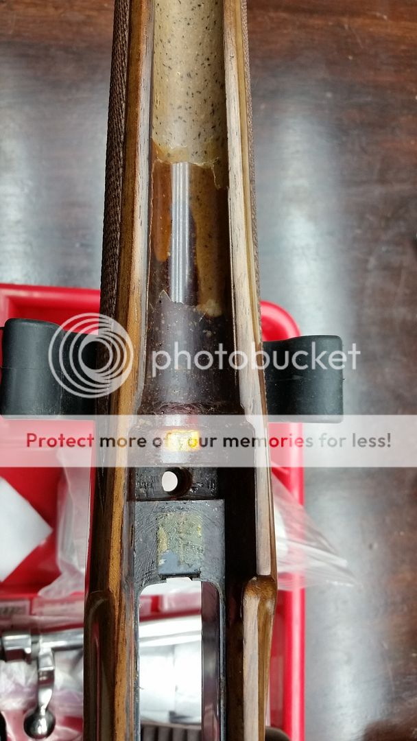

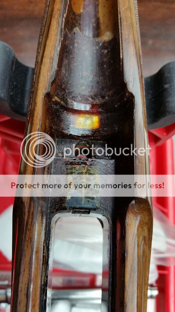

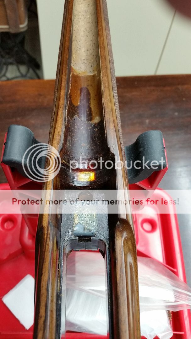

I appreciate all the helpful suggestions but I learned a long time ago not to force things. Lucky I stopped to ask here or I would have done damage. Once the action separated from the stock I could see there were in fact 3 bedding jobs. 2 real & 1 ????
An original first skim coat of some sort that runs the full length of the fore-stock, then a glass bedding around the recoil lug action and magazine well and finally up towards the fore-stock someone added what appears to be a softer rubbery type glob ....... that's what could be seen oozing out. I'll attached some pics tonight.
The trigger guard and mag well are apparently permanently bonded in place it would appear.
Here's a few interior shots. You can see multiple beddings. An original skim coat full length then the glass/epoxy? around the action. Finally a blob of softer stuff that is what we saw oozing out!
