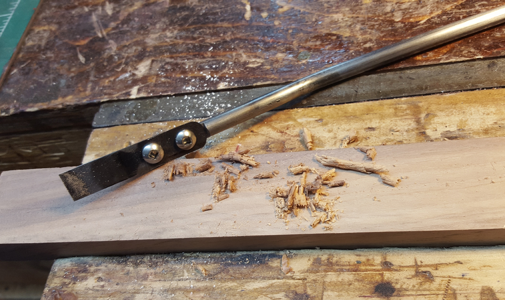

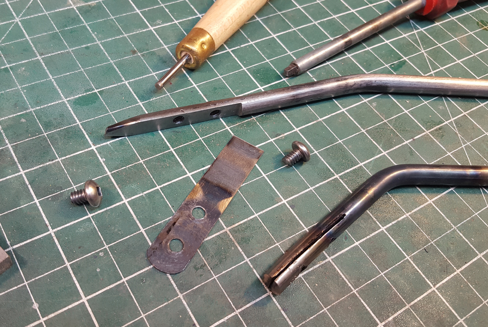

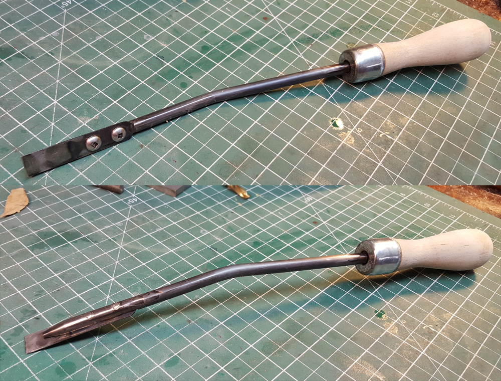

I took a long look at this when I started, I do have a lathe, but it would be a hard argument to get me away from flat scrapers, they remove so much material cost next to nothing and can be made to shape in about 10 minutes. You said you had one? what is the edge geometry on the disks? are they relieved or is it just a 90^ edge?

I don't have one of those barrel channel scrapers, looked at one at a gun show, guy wanted a lot for it, I learned what I figured I needed to know from getting hands on it.
