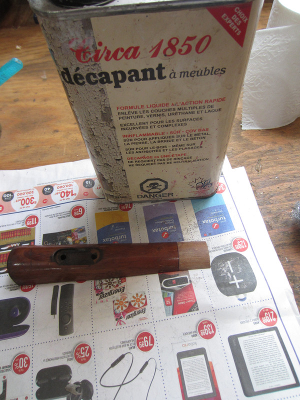

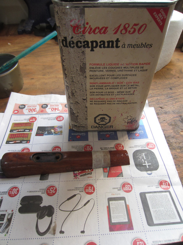

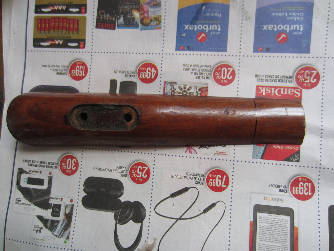

They say a picture is worth a thousand words.
You can see the tape was well wetted with stripper. I do not take the armchair approach and tend to only recommend methods I am familiar with.

When I refinished one of my guns, I allowed the stripper to disolve the white spacer. After the stripper was done, I cleaned the gap, carefully masked it off and filled it with a black epoxy. I think it looks better than the white.

Use a proper painters tape as well and you’ll reduce the risk of stripper creeping underneath, if you have any autobody paint/supply shops close buy look for auto paint specific masking tapes. FBS makes both crepe and vinyl masking tapes that don’t allow paint bleed if you use it right, clean and degrease the area first. I usually use windex and the isopropyl to pre and clean before masking, no issues with bleeding under the tape. Regular masking tape will soak up and absorb, painters tape won’t generally. Even the blue 3M painters tape at the big box stores will work better than plain masking tape.
Good post.
The masking tape in the example I posted was regular masking tape and the area was prepped with water. There was no creeping or bleed through. However, I did not eave the stripper on any longer than necessary and that might have been a significant factor.
