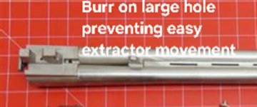

Picked up a new blued fixed choke 20 gauge Coachgun that needed work right out of the box.
Safety did not work.
The bar that moves over the triggers to prevent operation was too long.
Fixed that with a file, but thumb slide was extremely difficult to move..found the roll pin jamming against frame, means hole was drilled in wrong spot, more file work.
Extractor was very difficult to move and found a spot weld not ground down rubbing on it, more file work.
LockImpeller-768x460-3692745311.jpgLockImpeller-768x460-3692745311-1.jpgth-2799979049.jpg
While it was opened up I shortened the impeller lock to permanently disable the auto safety and cut 1½ coils off the spring and polished all the mating surfaces.
It's crazy you have to do that to a new gun
