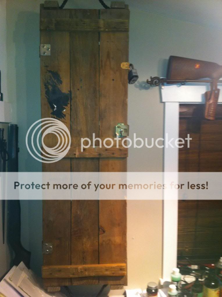

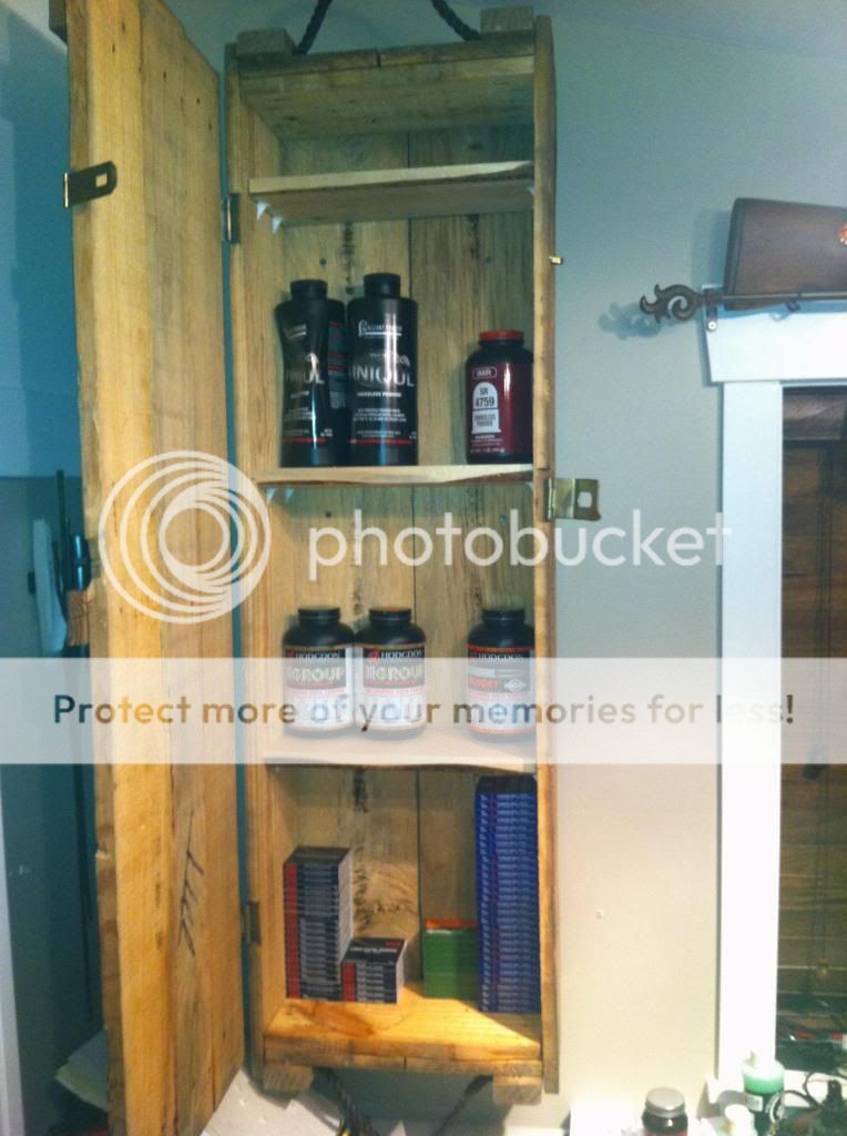

What i use:
surplus 105mm wooden crate, $25 at princess auto recently. just put some shelves in it, already has brass hinges/latch, i added the lockable latch.
Before this big guy i was using 2 wooden ammo crates, surplus 7.62x39 and a 7.62x54r crates, just add the hinges and a lockable clasp, easy storage and you get a reason to hang some surplus on the wall.
That's actually damned closed to what the regulations state. Pretty good for essentially free.
