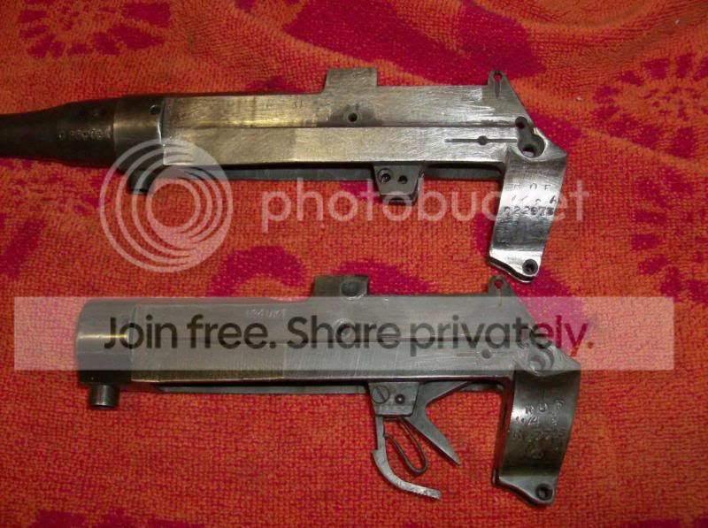

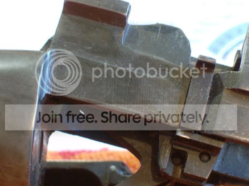

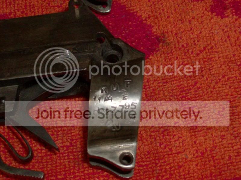

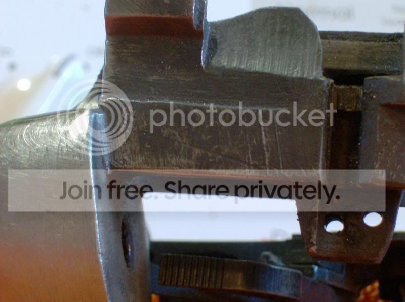

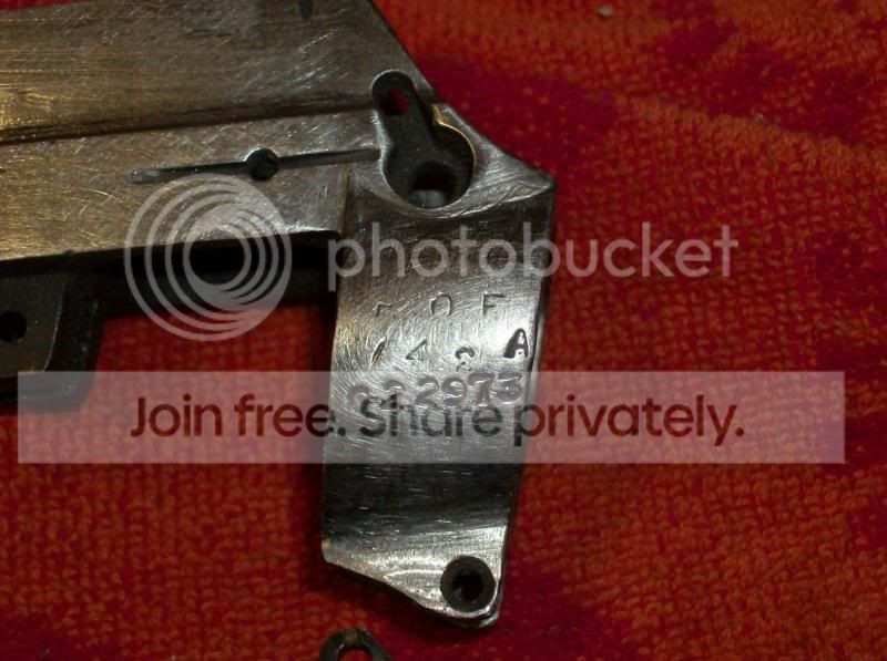

Thanks Ron, DP51, much appreciated. Here are extra pics. Both receivers bear the ROF marking on the left side, and there seems to be quite a lot of info all jammed into a pile of nunmbers and letters. You will also note that in the first picture the top receiver was worked on... very badly by a previous owner. Not sure what the intention was, but the result isn't pretty; not sure if I'll be able to do to it to lessen the horror.
