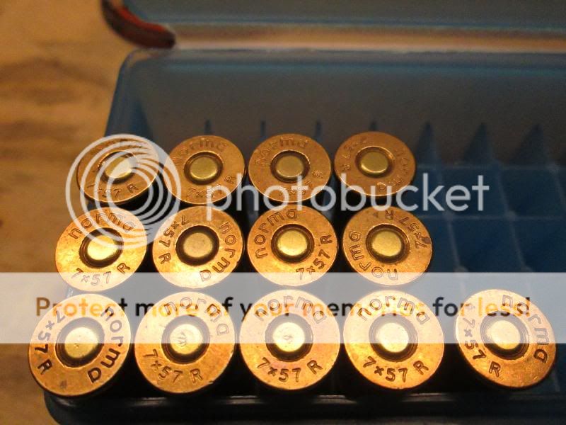

I found these light primer strikes on ammo that was cycled through my BRNO ZH-204 a few times while hunting this fall. The lower left three are the ones in question. None other went through the rifle.
Any thoughts/explanations/theories?

The only image with primers visible on your album is this one,
Is this the picture in question? Those primers don't look touched at all.

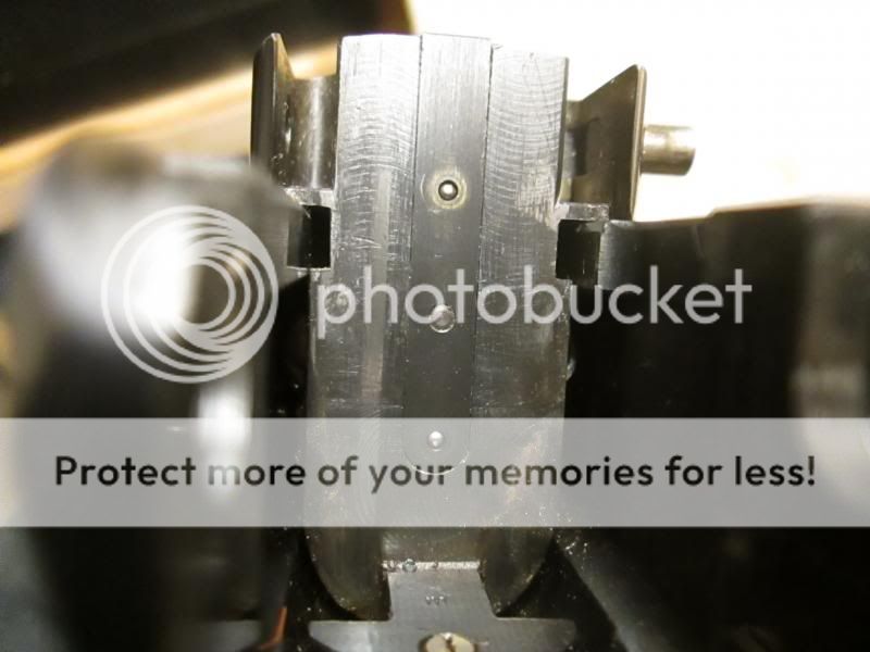

First tell him to check for burr around the firing pin hole(s). Then check if the firing pins are retracting far enough into the receiver....
I would bring that rifle to a competent gunsmith asap. Something's wrong. Could be dangerous.
I don't remember where I have read a thread, but the guy had trouble like this.
I think that it was about a big bore caliber used for white bear defense up north. IIRC the gun blowup.
Maybe you could do search. In the forum.
Mush
Are you 100% sure the marks came after they were loaded?
These reloads?
Did you have a moment where the primer tool handle was pushed
a tad further than you usually sqweeze?
Didja drop a box of ammo they were in?
How about the thought that you shot the bottom barrel and the kerpow
cause the firing pin up top to kiss the primer?
