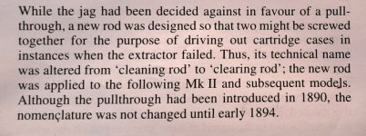

While the original reason for the cutoff was to single load, this was soon discovered to damage extractors & was discontinued in this role & the cutoff was regulated to a safety feature, when cleaning rods & jags were replaced with the pull though the rod was redesignated as a clearing rod for the extraction of fired cases stuck in a rifle with a broken extractor

I am currently looking for references but here's one on the Cleaning/Clearing rods

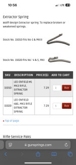

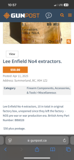

Showing people photos of these parts/prices doesn't indicate there is an issue with breakage. It only indicates they carried the spares.
