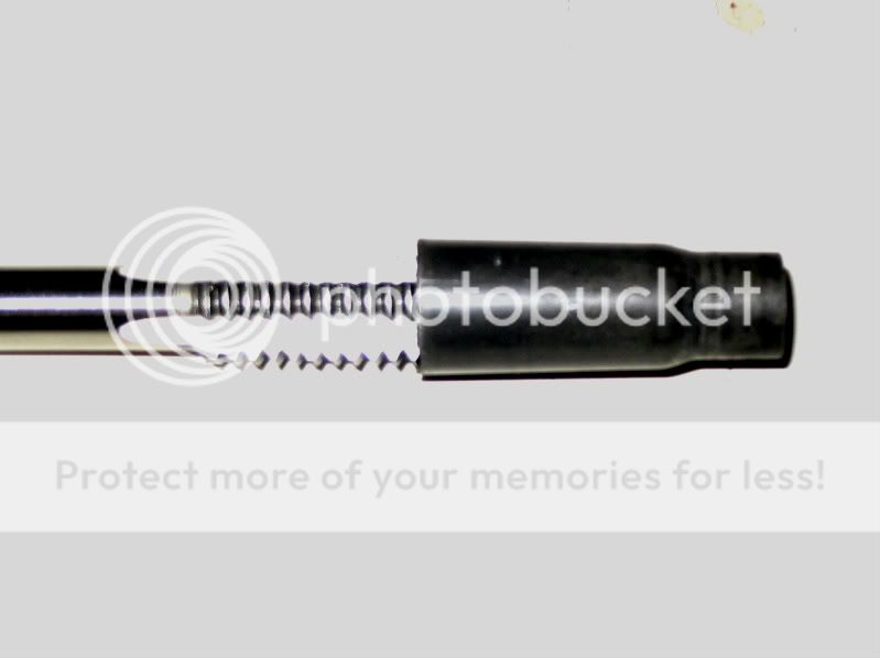

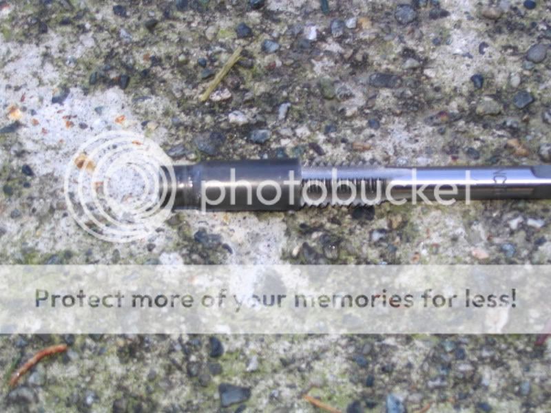

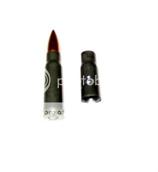

lacquer thinner removes laquer based paint.Good thread. My rifle extracted 1/2 steel case, other 1/2 stuck in chamber. I did the heat gun, starter fluid, then 3/8 fine tap from the chamber end, and it popped out with a few firm hits with a rubber malet on the aluminum cleaning rod.
