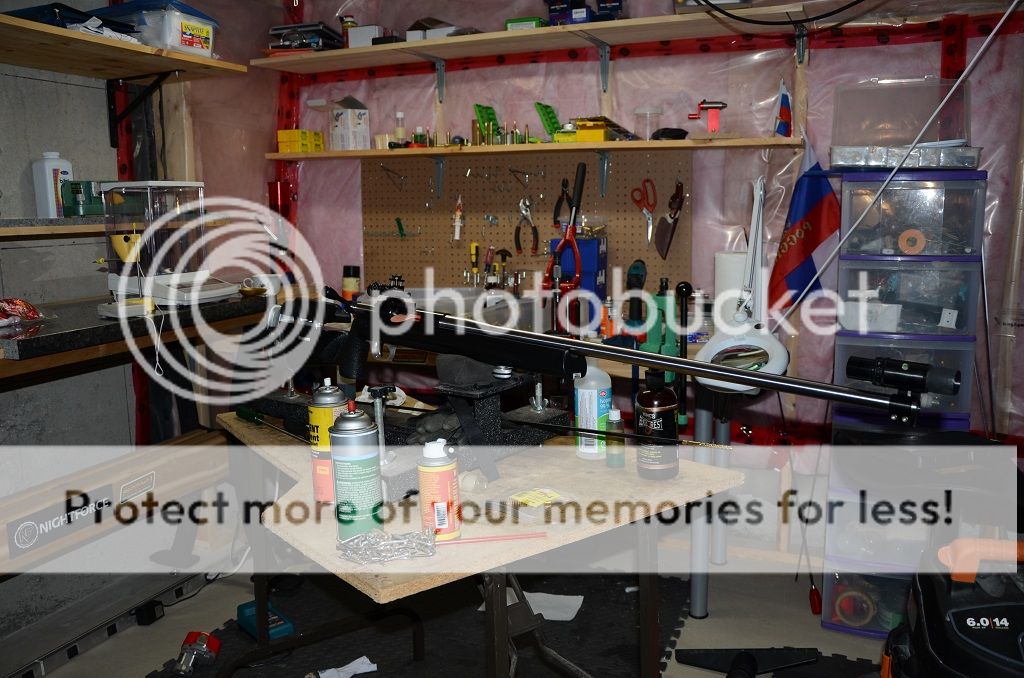

Rifle:
AlexNoks, that is some fine shooting. Obviously all the parts have come together. You do know that you are 1 scope base away from F TR? :)
Nice scale and set up. Granite table top? Love the Lee powder measure in the background.
All the best for next seasons matches. Too bad, you don't have anymore EXCUSES...
for those that do not know, that white "box" on the LHS of the pic is likely worth as much as some rifles. This gents loads are consistent to the KERNEL of powder.
