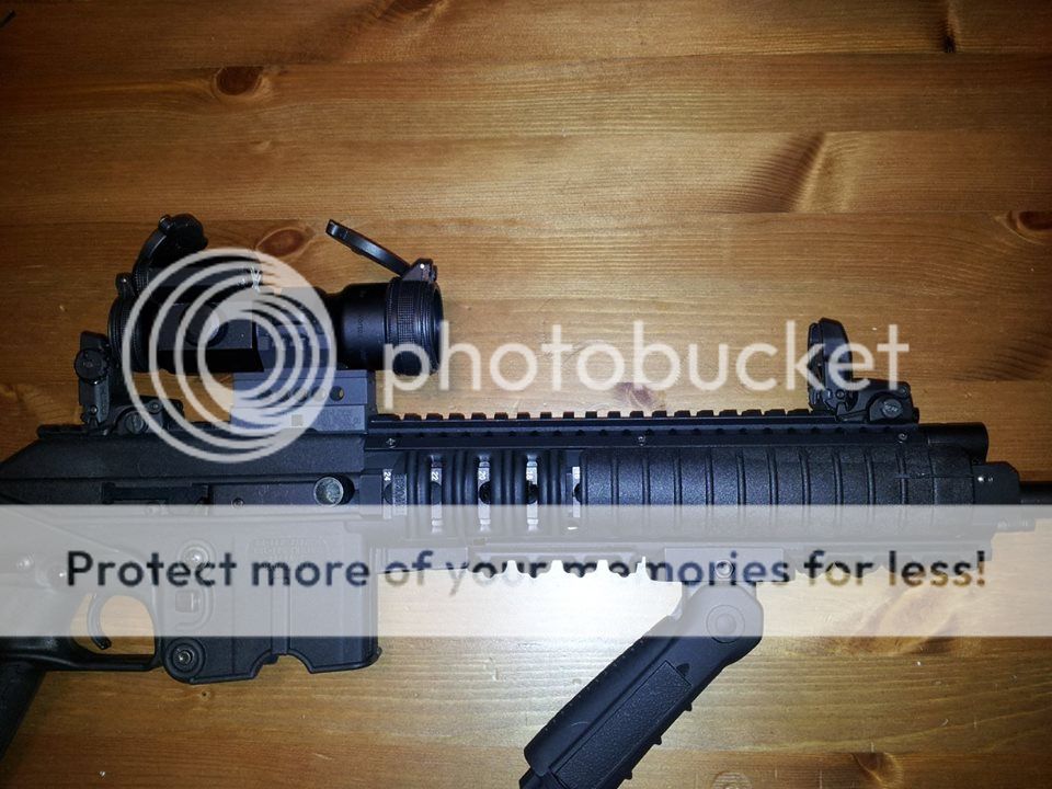

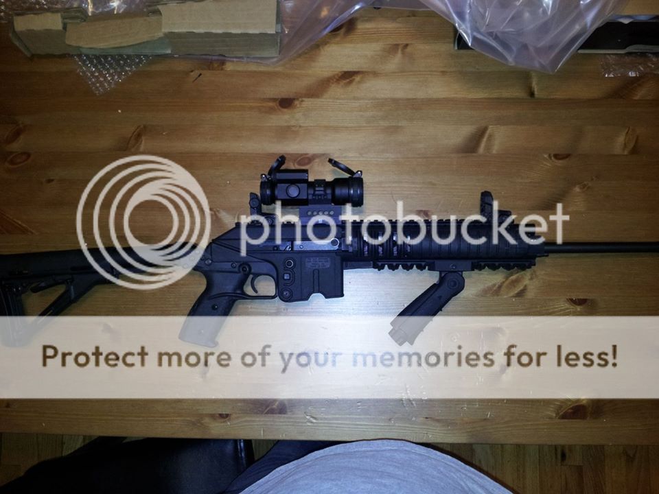

Here's a pic of the regular SU-16F with the TuForce end adapted and a couple other small additions. Built this one for about the same price as the FX
So here are the best shots I could find, sorry about the quality.
Here's the overall build, minus the AR flash hider. That's a Magpul MOE commercial butt-stock. So keep in mind that the adapter kit uses a commercial tube.

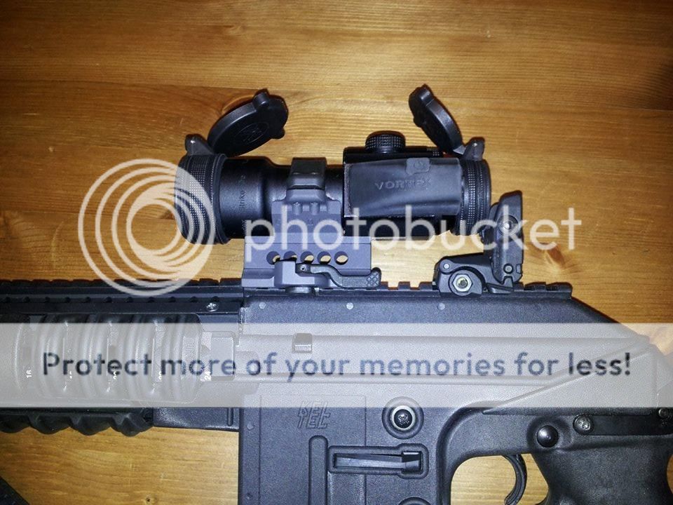

Close-up of the Vortex Strikefire and Arms QD Ring/Mount

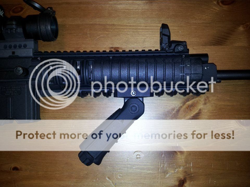

A close-up of the handguard in it's current config. It takes a bit of modification to get it to fit but as you can see the result is a nice mono-rail. I may pick up some full length rail covers later. That's a magpul vertical grip, I may be changing that out for something shorter or possibly pick up one of those AFG's.

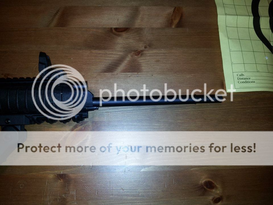

And as mentioned, I'll be cutting, crowning and threading the barrel to add an AR flash hider (or "birdcage") when I have the tools
