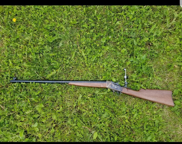

I have been testing a lot of different combinations of powders, lubes, wads, primers, etc with my Pedersoli 45-70 rolling block lately, striving for the best accuracy I can achieve.

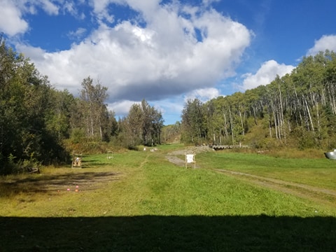

Where do you shoot?
