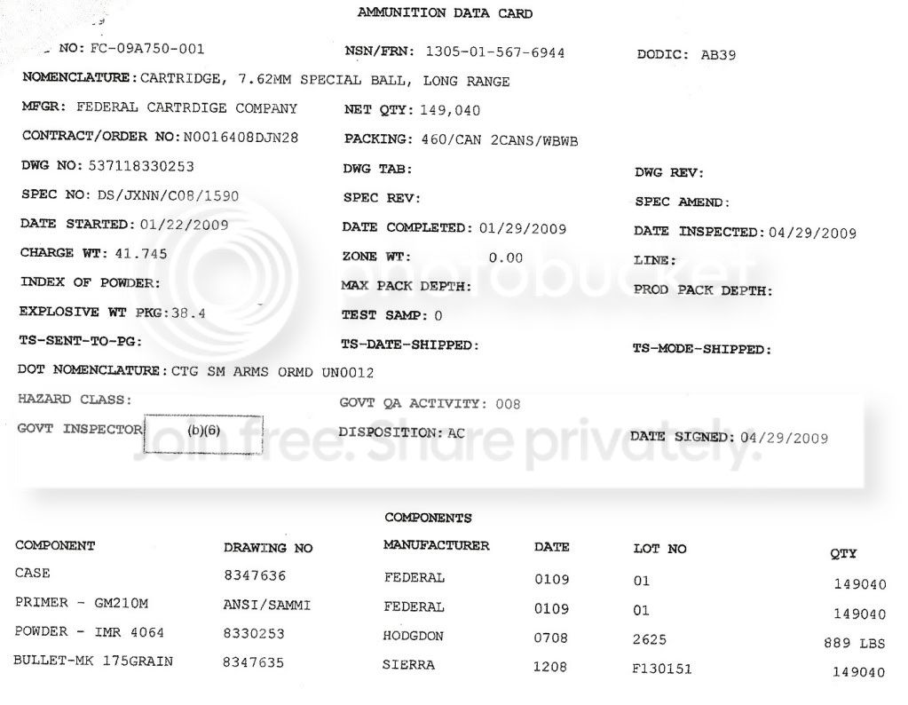

my new rifle ,loading for it is kicking my bass- varget doesnt seem to work well in it...wierd hey? anyhow federal gold match 175 gr smks factory prints under 1/2 moa groups and they use Rl 15 but thats unobtainium so whats a good substitue for rl 15 ? or any other companies make the same stuff with a different name ?

I would suggest IMR4064 or BLC-(2). The letter seems to have few proponents, but next to Varget, it's my go-to powder in the 308 for which it was designed.
thats a cool find dogleg....think they use to use 4064 but switched to rl 15 for their m118 sniper round/federal gold match too maybe(from googling it/sniper hide forum or some such) . but yeah ill definatley load up some 4064 and see how that works....still have a can left over from 5-6 years ago when doing initial load testing for my target 308 years ago. and i have blc2 so hopefully one of them works in this newest rifle.
think i talked to a sierra tech too a long time ago and they said they use rl 15 in the gold match/military loading ....i had told them my sniper rifle didnt like rl 15 he thought it was wierd. i recently pulled one apart and it had 43.3 gr in her .

Dogleg, I saw that sheet, so pulled a bullet out of my goldmatch at home and it was more like 42.5gr (yes, calibrated RCBS scale). Sad to hear the Varget isn't working out; I got 6lbs of it and was hoping to work up this very same (308 175gr SMK).
thats wierd ,the one i pulled was 43.3(maybe mine isnt calibrated) ....maybe go ahead and pull another ...ill wait here for the results...go ahead. and id say the varget should work for you , i shoot 175 smks out of my target 308 with varget for a long time now and stupid accurate ,like under 4 " at a grand accurate. (3 shot group once last march).44.6 was the load for the factory barrell and 42.3 is for the T.G .barrell it has now. 2700 and 2600 fps velocity. im thinking its the hunting rifle of mine i recently purchased dont like varget ,a kimber m84 select ,super lite. wanted it to shoot barnes 110 gr for a low recoil coyote rifle /300/400 yard deer rifle ,but couldnt get those to shoot so i tried some of the factory gold match rounds i had kicking around for a while and voila magical 1/2 moa group ,and recoil was quite acceptable/pleasent. with 42 gr of varget and the 175s recoil was a lot more vicious rifle only weighs just 6 pounds ,
