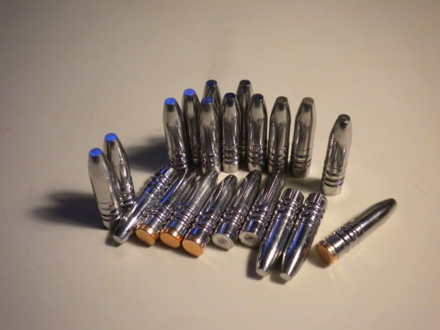

I cast a 247 gr .311 bullet that was designed for subsonic shooting in the 300 Whisper cartridge.
In the 30-30, 10 gr of Trailboss is about 90% case fill and gives 1025 fps in a 20" barrel using the 247 gr bullet. That's just about perfect.
Quickload estimates that all the powder is burned within the first 10", which I can't prove but it is very quiet.
Do you have a pic of those 247gr subsonic bullets? Sounds cool.
These pictures are from Cast Boolits website. I got the mold on a group buy there. The mould is 4 cavity, 2x gas check and 2x plain base. I loaded the gas check version up to 1950 fps in the 30-06.
