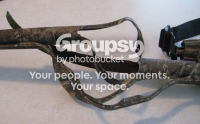

Here is a winchester x3 barrel after firing a hot winchester load. Wonder what his hand looked like. At first they tried to say plugged barrel , rag etc but in the end nope too much pressure developed
Based only on that picture I would suspect a barrel obstruction caused the burst, as it seems to have occured forward of the tube magazine.
Yes normally I would agree with you but not in this case. There were a few barrels blown up and it was eventually linked to a hot batch of winchester expert ammo. Winchester actually paid 1/2 of the cost to replace the barrels.Here is another one, plus one on a 1187 etc.
