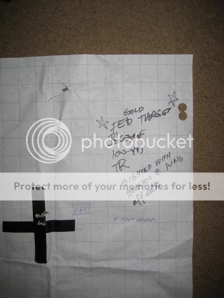

finally finished!
taken a little while, have finally got the Burris Signature Zee rings that i got from Mystic Precision on the gun and did the "chasing the bullet" thing that the directions and Jerry's article talk about.
so I put the crosshairs in the center of their adjustment range and plopped the scope into the rings with the "0" or neutral inserts and this is where the rifle shot at 100 yds:
I thought I would try to get all fancy like in the directions by using the 20 MOA insert at an angle. nope. the next tactic was to work at 90 degree angles - much simpler - so after finding that i continually put the inserts in the wrong ring :bangHead:I started getting somewhere. used the 20 MOA to "push" the scope down and the 5 MOA insert to "push" the front of the scope to the left.
A fellow at the range who has these said that he found he could virtually sight in his gun by very small tweaks to the inserts. Crums, the challenge was on. After the 9th time of removing the scope and twiddling the inserts I do believe i have got close enough. I must say that this little job is not recommended for the emotionally fragile - i find it embarrassing when i cry at the range...........................
cheers!
