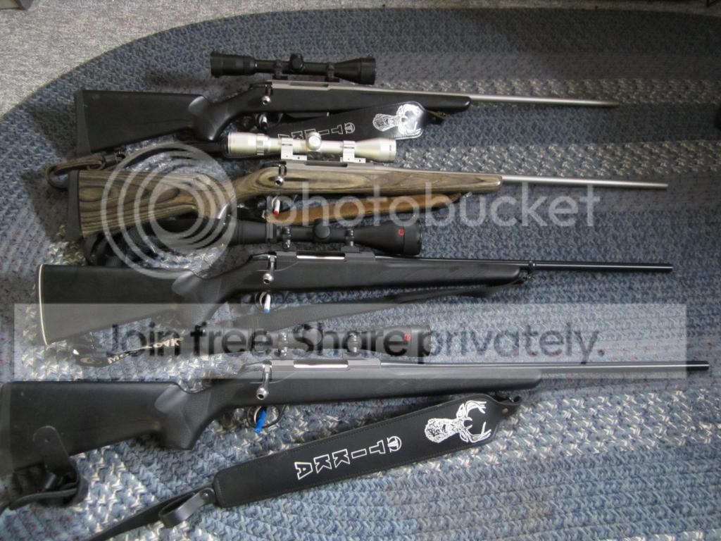

I own 4 T3's, 3 are my main hunting rifles. I like them because they have a very slick bolt and good trigger. One allen key and you can lower the trigger down to 2lbs with no creep, prefect for hunting I think. All the scope I have on mine were around $300 when I bought them. I like the Redfield better than the Elites now, and they were cheaper too. They do have a lot of plastic on them but keeps them a nice light affordable hunting rifle, and all mine have shot the guarenteed 1" at 100 yard group as well.
Listed from top to bottom: 300WSM Bushnell 3200 Elite 3-9x40mm
300winmag Bushnell 3200 Elite 3-9x40mm
.308win Redfield 3-9x50mm Revolution
.22-250 Redfield 4-12x40mm Revolution
